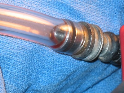

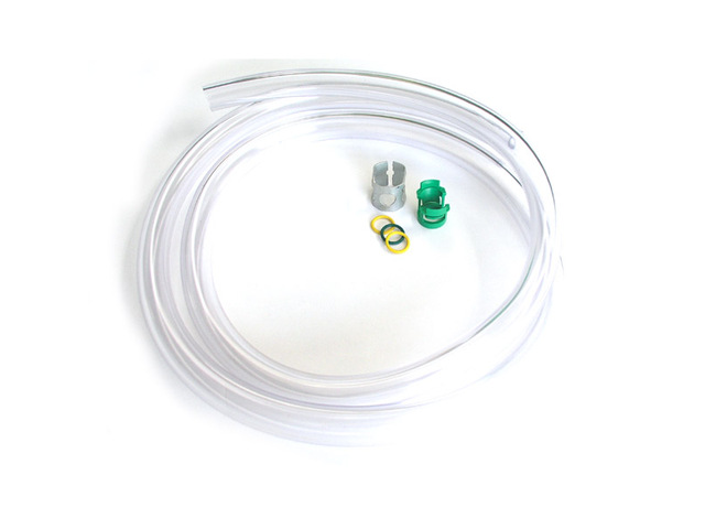

I want to flush my tranny soon to the discoloration and new owner of a used volvo 850 w/over 230k. IPD sells the tranny flush kit for $24.95 but they are on the west coast and don't feel like waiting. Now that hose from the kit can be purchased @ any home depot, i just need to know the size. The washer and clip and O ring i can pick up locally from fcpeuro. Any know the a good size to use ?

I found the size by doing some research. You can use a 1/2 hose to perform your flush on any p80. 1/2" ID 5-6' clear plastic line connected to transmission fluid line coming from the transmission. It should be clear so you will be able to see the fluid running through the line.
