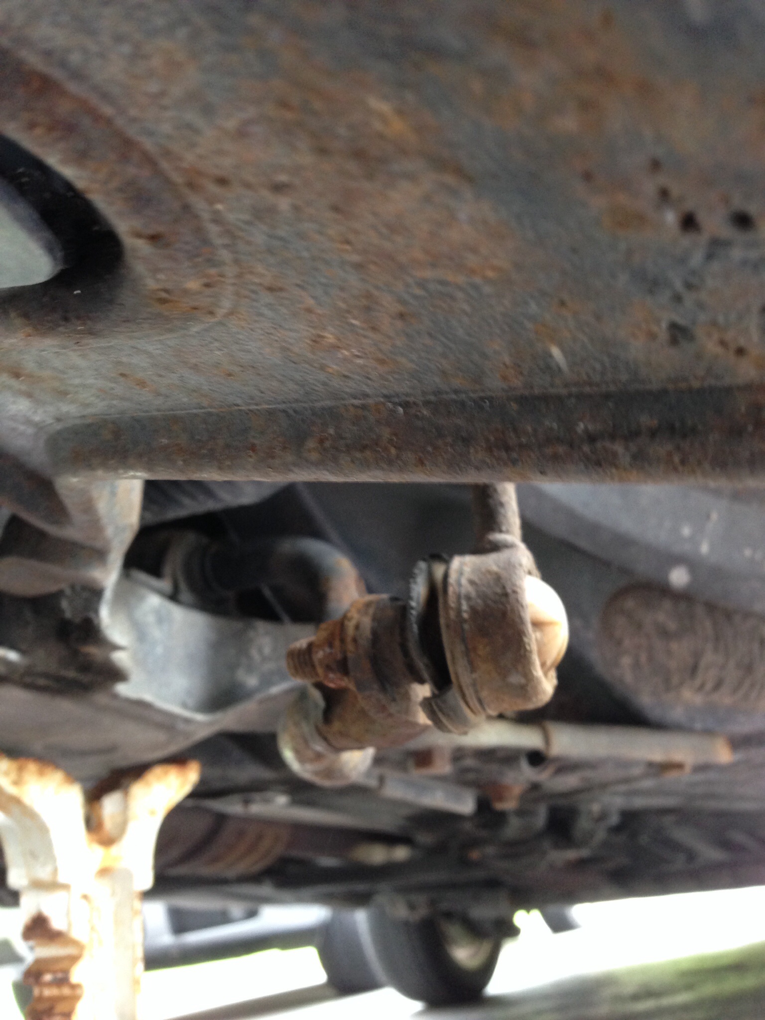

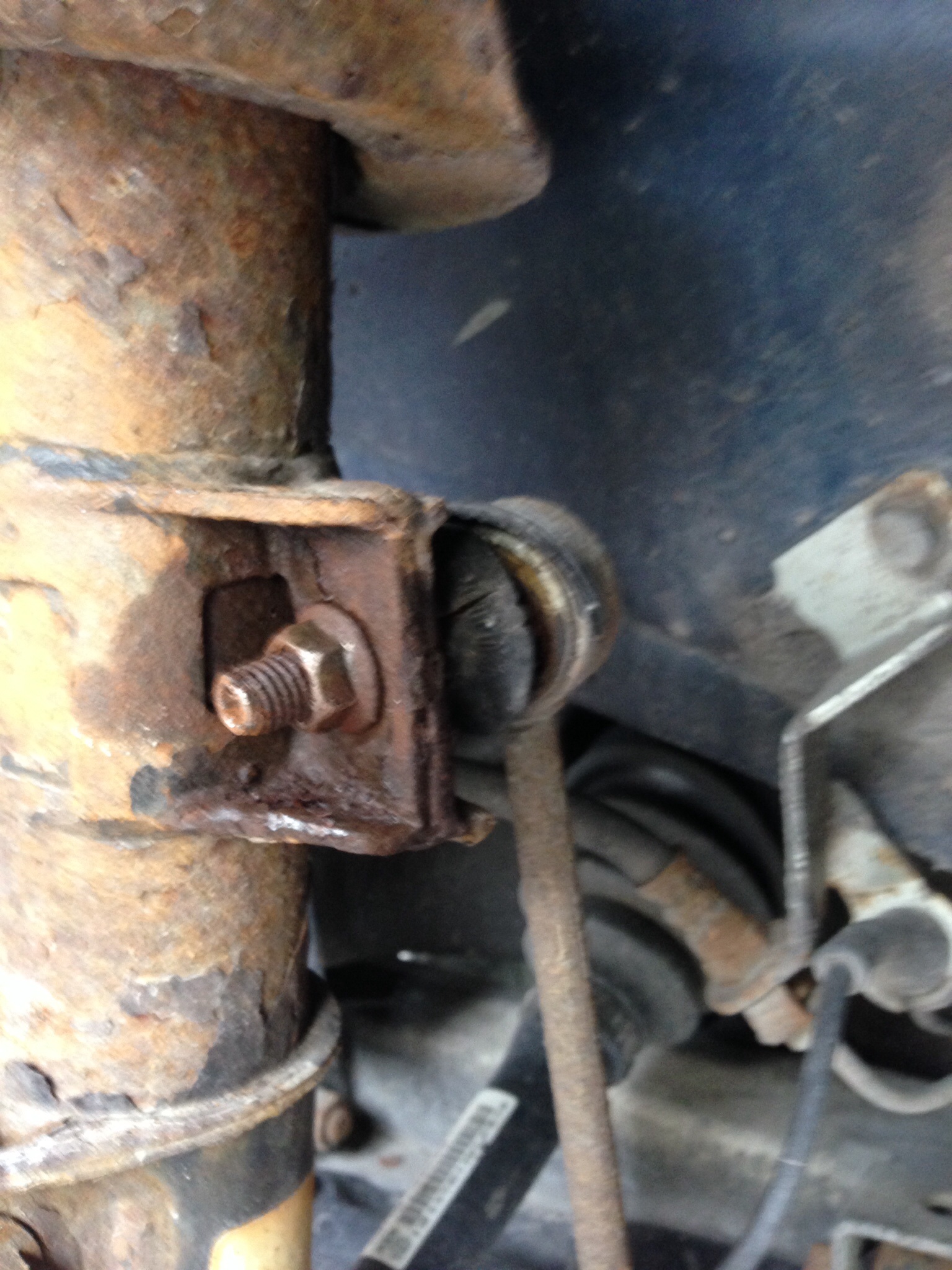

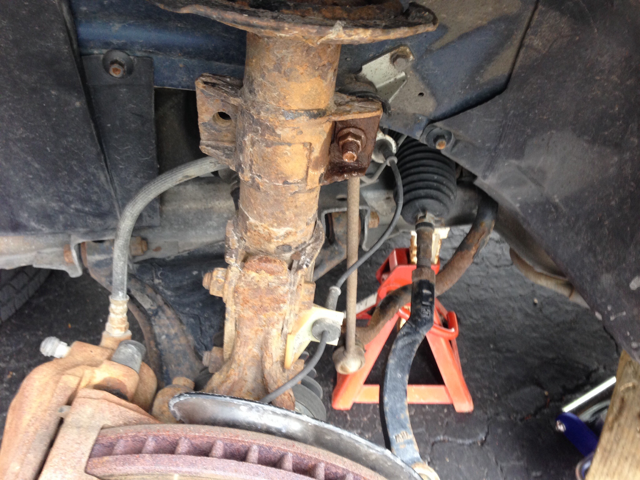

End link pictures. Please don't let the kids see these.

Hmm always thought ALL models had reduced to only one knock sensor after finding only one on my '99 Denso car a couple of years ago....perhaps the ME7s still have two of them.
Angle grinder all the way as far as getting over 15mm of metal off....you can do it with a Dremmel if you have 2 or 3 cutting discs.

Thanks Mike.
Do I grind off the nuts or should I try grind off the whole link end on the other side.
I'm a bit worried that I can't get the whole nut cut through because of that recess.

Once you grind off the hexagonal area of the nut straight through with the grinder the shouldered part of the nut will just fall off as it has nothing to attach to.
On the other end of the endlink is a ball so that will simply NOT pass through the hole unless you grind that off instead of the nut. I would go for the nut first (said the chipmunk)

I trained my daughters to go for the nuts first, too.

Ill do a separate thread on this, but went out to do the links again at 1100, and by 1221 was back at the computer, links done, tools all put away.
Abscate 4 - T5-3 I get credit for all four link nuts.
Photos and database worthy write up to come
