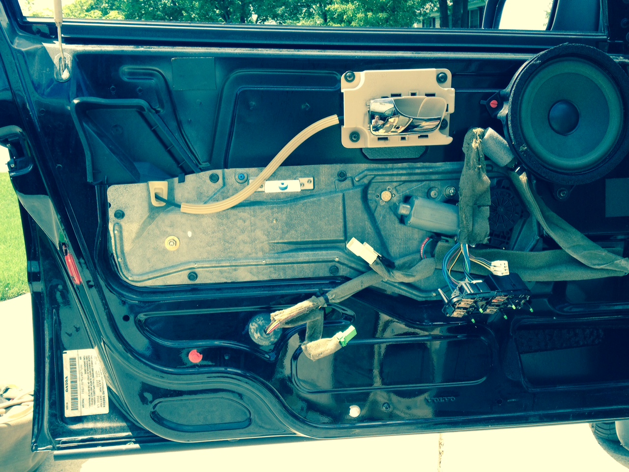

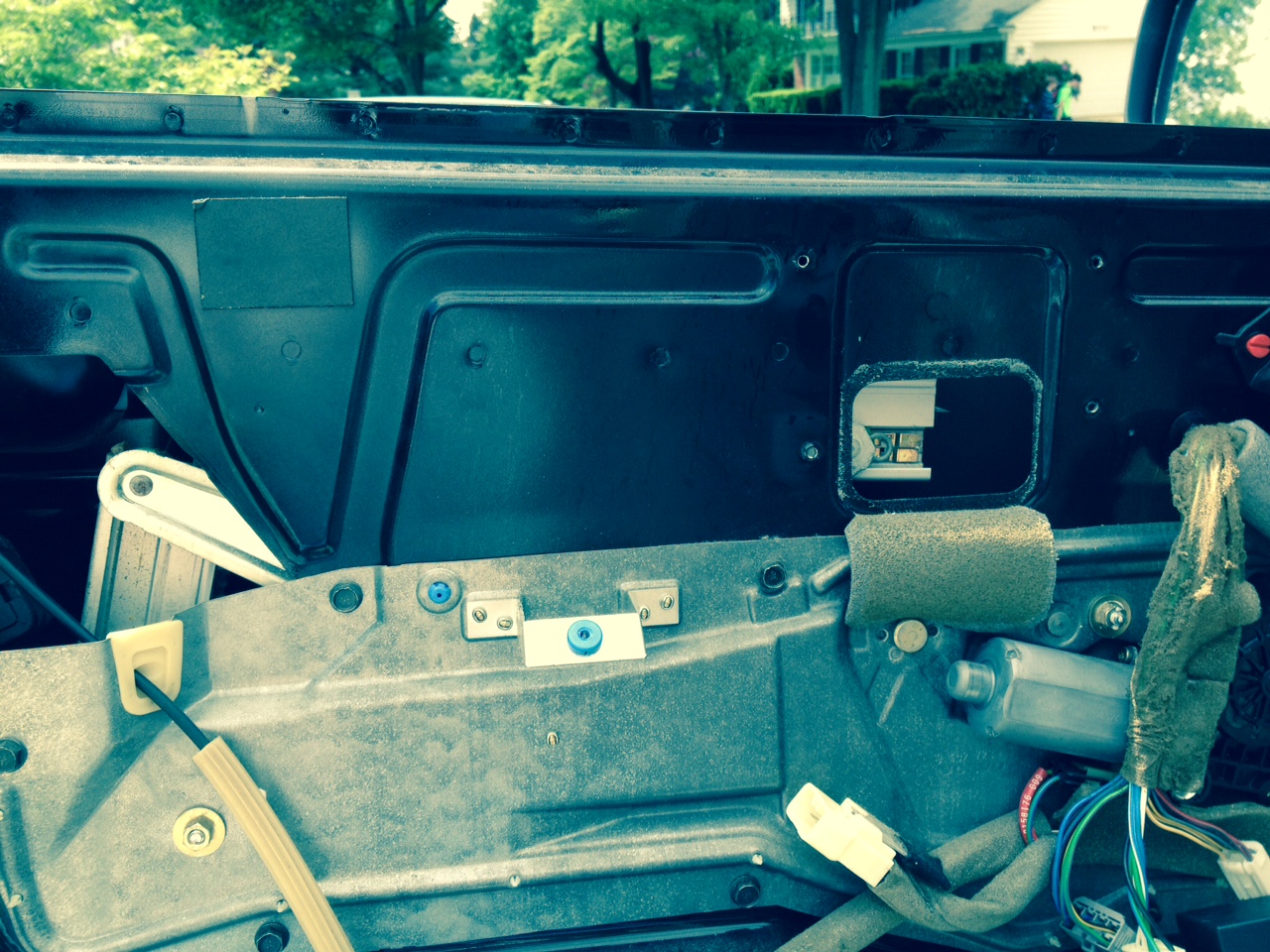

Thank you for the very helpful info. Here are some additional tips:-
1) Be sure to vacuum and clean out all the broken glass pieces from the side & top tracks around the window frame.
2) To access the 2 retainers that are holding the bottom portion of the broken glass, you will need to remove the door panel, then the door release (on right) and a plastic cover (on left) . Somehow you'll need to re-attach the window control module and lower the mechanical window arm to the level where you can see the retainers. 3) In order to insert the replacement glass from the top, you'll need to remove the top inner trim
