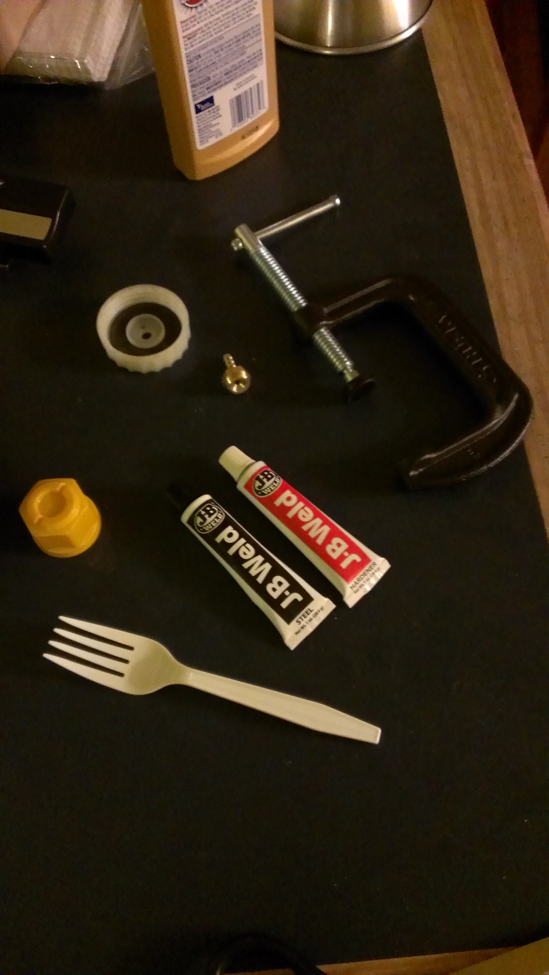

I used the following items:
- 1x ATE old-car brake reservoir cap - http://www.fcpeuro.com/products/volvo-m ... ap-1272107
- 1x Home Depot "HDX" 1-gal garden sprayer - http://www.homedepot.com/p/203809533
- 3x 1/4" NPT to hose barb fittings (this sprayer uses 1/4" ID hose)
- 1x hose splice, 1/4" ID hose
- 1x 1/4" NPT brass female pipe tee
- 1x 15psi gauge with 1/4" NPT threads - http://www.mcmaster.com/#4089K61
- JB Weld
- A C-clamp
Using a hacksaw, cut the threads off of one of those 1/4" NPT-to-hose-barb fittings. Clean and rinse the fitting thoroughly so there are no chips remaining. This just keeps the cap from dipping into the brake fluid when you install it in the reservoir, to reduce mess. If you don't have a hacksaw, then don't worry about it.
Drill a hole through the reservoir cap big enough to accommodate your hose barb. Not too much bigger, but it doesn't have to be perfect.
What you need to build the cap

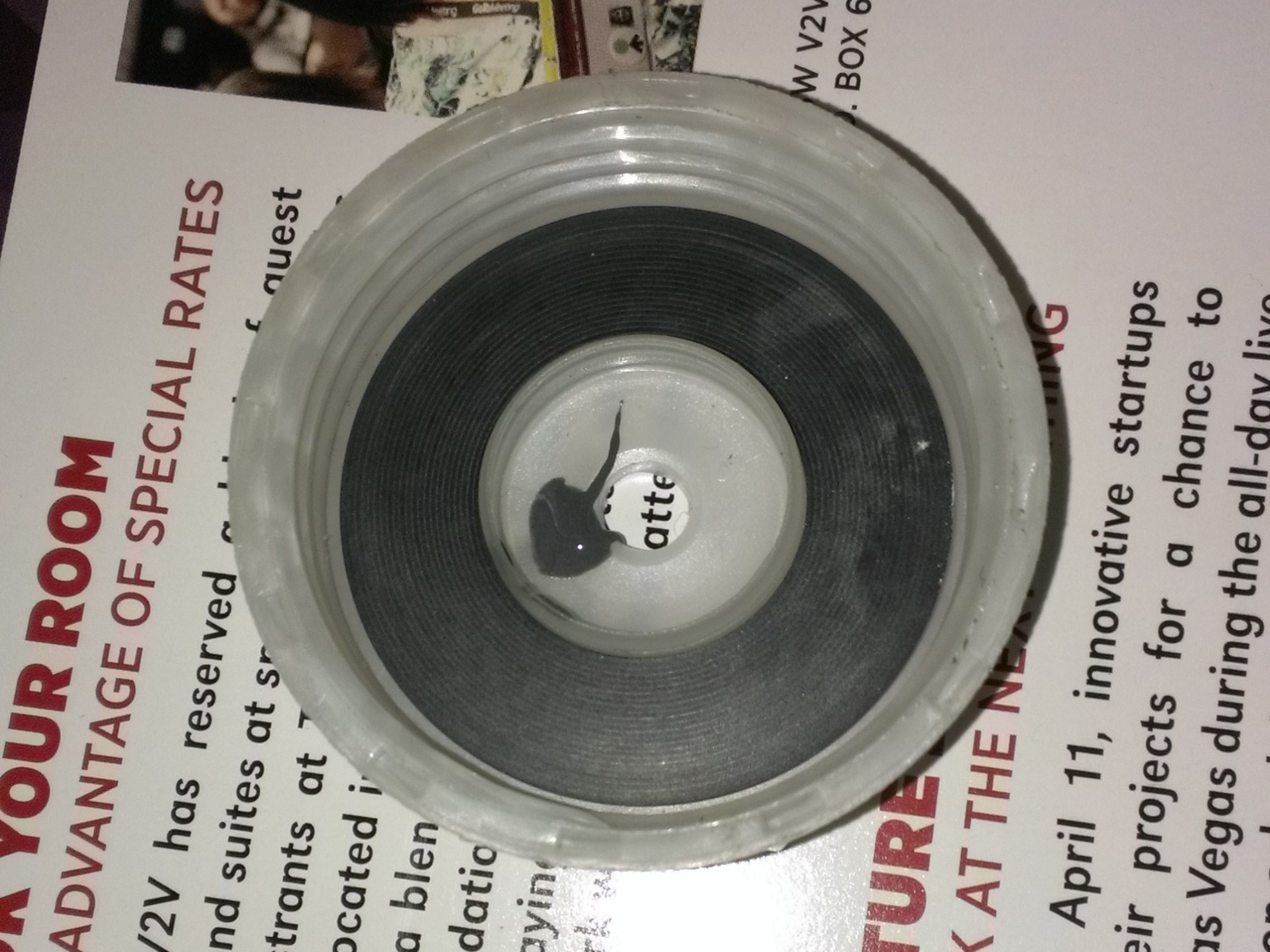

JB Weld, as you may know, is a high-performance engineering adhesive, used exclusively in extremely scientific applications such as this one. Using a precision-engineered mixer/applicator device, such as a disposable plastic fork, seal the vent hole in the reservoir cap.
I'd recommend removing the rubber gasket before this step, actually

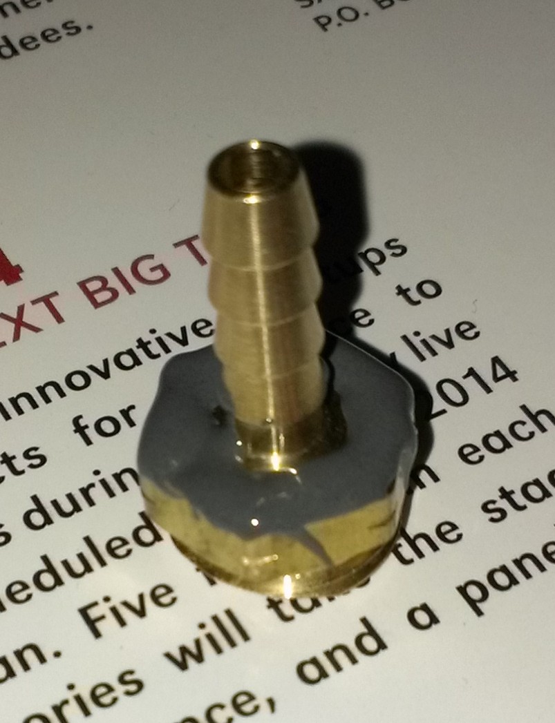

Clean the drilled hole with a Q-tip. Next, use your precision JB Weld applicator to apply a layer to the flat part of the hose barb fitting.
Hose barb ready to glue

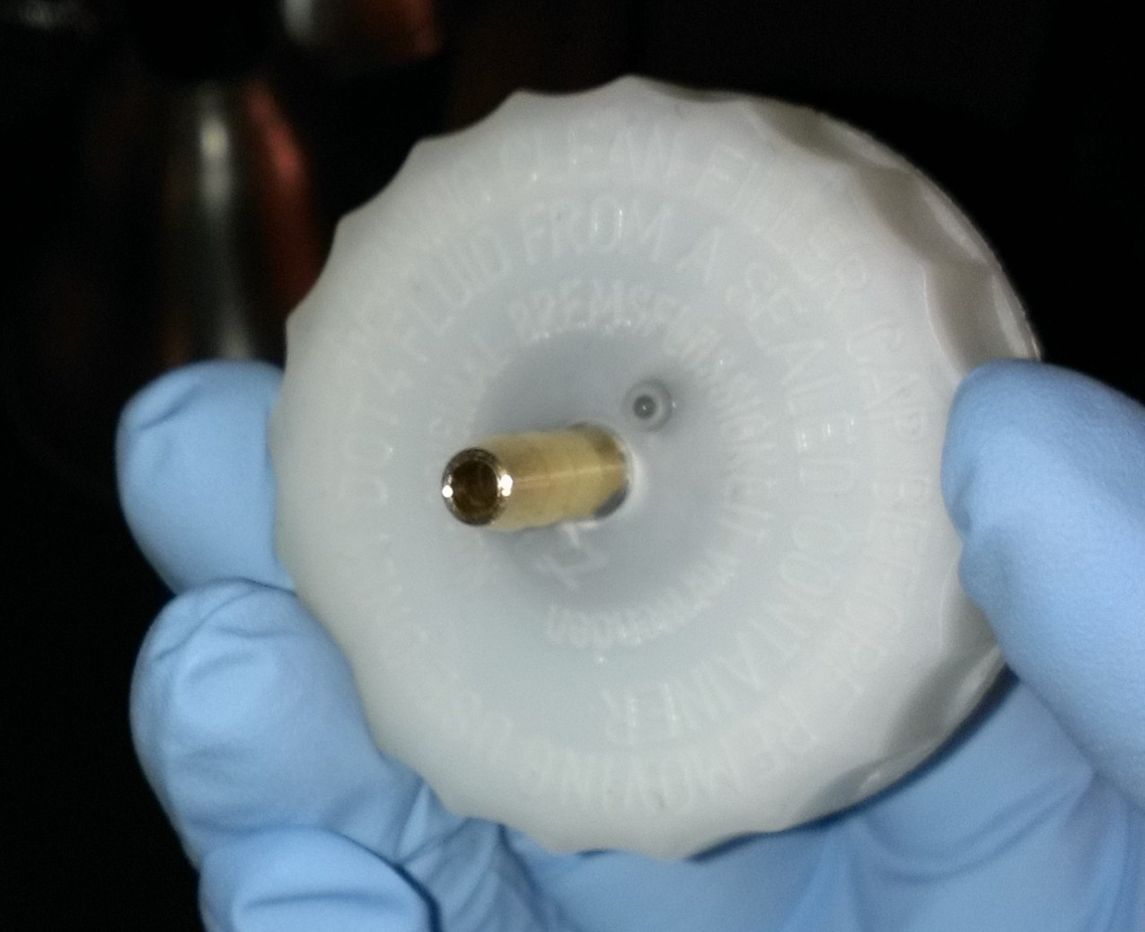

Carefully thread the hose barb through the drilled hole in the reservoir cap.

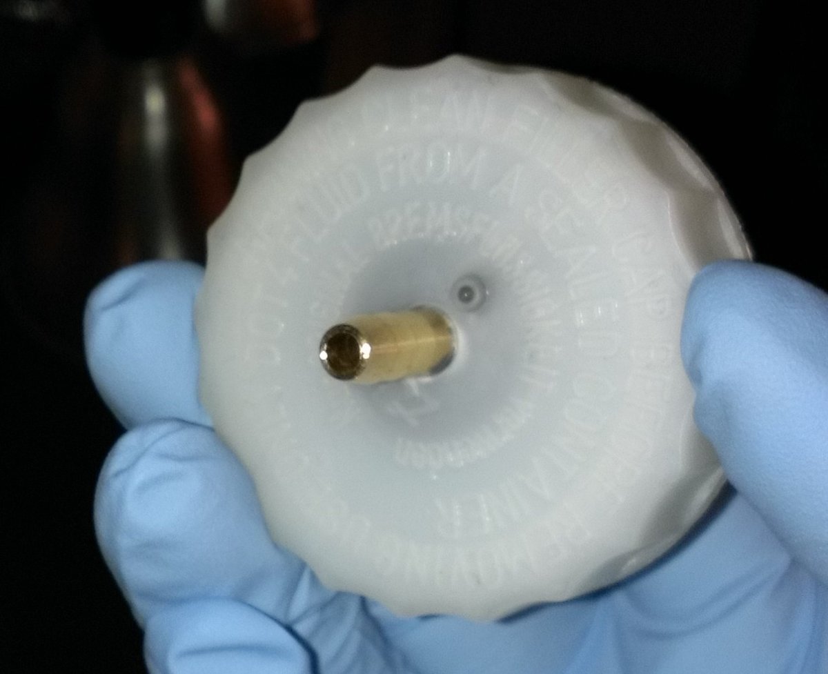

this is what the final reservoir cap looks like
Clamp it all together firmly enough to squeeze out excess JB Weld. You need to press on the upper face of the reservoir cap (facing camera in above picture) and the cut-off-threads face of the brass fitting. I used the yellow spray bottle cap in the first picture.
Let the Advanced Science Glue cure for at least 24 hours.

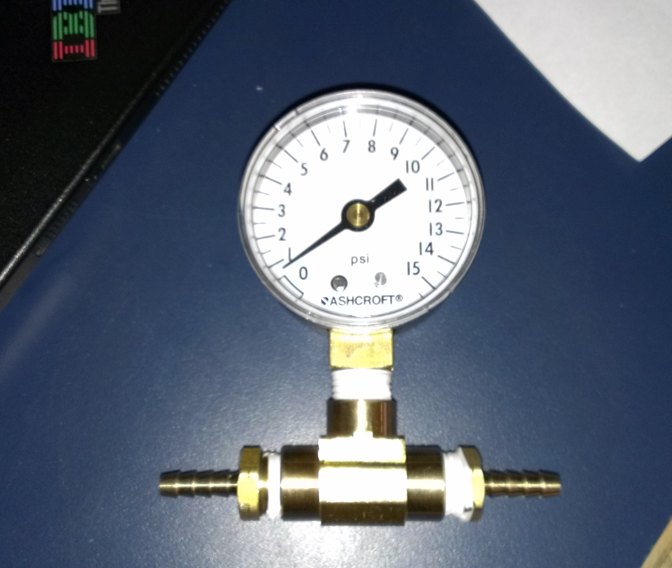

Wrap the remaining barbed fittings and the gauge with some teflon tape, and tighten them 1-1.5 full turns past finger tight. (You need a 9/16" wrench for 1/4" NPT fittings.)
i am not a pipefitter

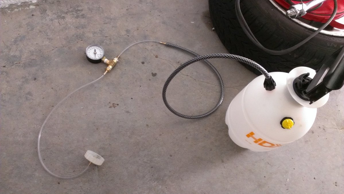

Put it all together as shown below, and you're done !
this is the setup
this is the setup
(note that i took this picture after the job. Avoid setting the cap on dirty surfaces beforehand.)
The cap screws onto your reservoir. Bleed as you would with any power bleeder.
installed and operating.
