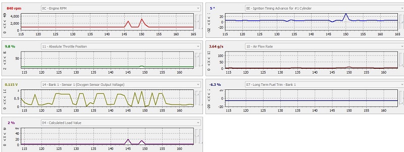

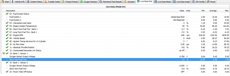

Hi everyone.My first post here, I need help. As above my car V70 170bhp non turbo has small value of engine load also weak airflow (as you see my data from obd).I did change Maf, Throtlle sensor,Fuel regulator, Lambda sensor ,all ignition kit and car still drive with lack of performance.My catalyst seems to be ok .I have no idea ,what causing my problem .Just find some of data - Calculated Engine Load(%) 90.98 max 10.58 min. Any idea guys?
full throtlle.jpg (66.63 KiB) Viewed 756 times

Weak airflow suggests a leak (vacuum) or poor compression.
Start with a compression test.

Ok are you experiencing symptoms or are you just concerned with those diagnosric figures? Any codes?

Does your OBD II tool show intake air temperature?

Air box was blocked and spark are genuine from Volvo garage.Biggest issue rpm go slowly up to 3k(take ages),I dont know why. From 3k seems to be better.Fuel pressure ok but I need to check voltage under relay.Obd scan showing low engine calculated load,but no leak nowhere.Could be auto transmision causing problem?
