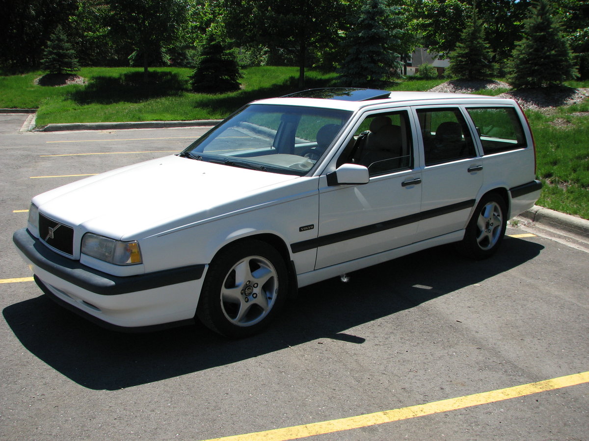

I have said it before, and been shot down by other members.
The reason I have a 1996 Turbo Wagon for the original purchase price of $650. is for the fact of the front O2 sensor not letting it idle.
I had only figured it out after swapping MAF, TPS, ICV, etc...
I had found a genuine Bosch front and rear O2 sensor in a salvage car that were new.
Either buy a new Bosch front O2, or find a salvage piece for diagnostics.
It is the very reason I have this car.
