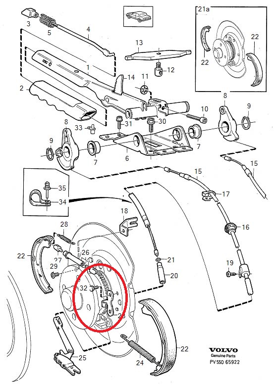

I think I messed things up, but not sure how bad. I was taking a look at the the e brake shoes and noticed that the tab that holds one of the shoes in place seemed bent so I tried to bend it back but then...it snapped off. The tabs that hods the ebrake shoes appear to be part of the dust (backing) plate and i am not sure how diificult it is to rempove and replace. Once I understand what is needed I will have to head to the local yard to see if i can find a donor.

I just noticed that the clip I broke is part of parking brake hardware kit from FCP. I'm not sure how these are installed. Can this be done without removing the backing plate?

I just noticed that according to the assembly drawing...the clip is shown to be held in by a cap screw. I'm going to have to take another look because yesterday I didn't notice anything that I could put a wrench on. Hopefully it's just a couple of cap screws that I missed.
