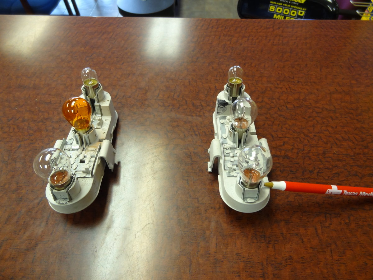

I need to know which lights light up when the brake pedal is depressed. I will include a picture of the 2 Bulb Housings out of the Left Rear Tail Light Assembly.
Left Bulb Holder(towards outside of car) is as follows:
Top Bulb - Parking Light
Middle Bulb - Turn Signal
Bottom Bulb - Brake Light
Right Bulb Holder(towards trunk) is as follows:
Top Bulb- Parking Light
Middle Bulb - Reverse Light
Bottom Bulb - Brake Light ? This is the one that does not work.
Remember, these Bulb Housings are from The Left Rear Light Assembly
On the Right Side Light Assembly, the Bottom Bulb in the housing towards the trunk does not light up either.

Ok got it figured out. This is my first Volvo and I have never heard of a Rear Fog Light. That's what that bulb is for. I just assumed that there would be more than 1 Bulb for brake lights on each side.
