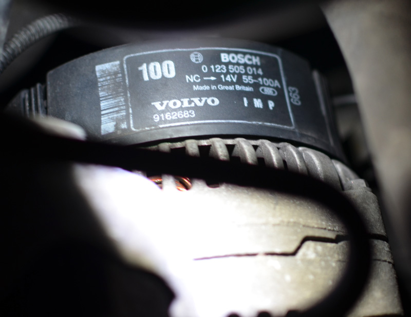

Does anyone know the dimensions of the Front and Rear bearings for 1996 Volvo 850 Bosch alternator? See label picture.
I don't trust the Remanufactured alternators. They put the cheapest bearings (if they replace them at all) and the cheapest voltage regulator. I will rather take the effort and get the best components to refurbish it myself.
The car has about 200K miles. I don't want to get stranded. I am also going to replace Starter Motor just in case.
@Robert/RSPI.. This is a great trick that you posted:) Now, how do I replace the bearings without removing the alternator from the car:)?
Does anyone know where to get Bosch Voltage Regulator for the best price?

- Alternator.JPG (88.83 KiB) Viewed 8697 times

I can't see how you are able to replace the bearings in the alternator without removing it because bearings are press fit.
If they spin okay, leave them. They will give you ample warning before they fail.

I've never had a bearing fail yet on an alternator. Same on power steering pump, AC compressor, serp pulleys etc. Overhauling is of course good insurance if you are looking for something to tinker with but this is not the timing belt path we are talking about - it is also fine to just leave them until they get noisy, like mecheng says you can hear the warning and change them at that time.
Alternator has to come out to change the bearings. Here are some good tips about alternator rebuilds in these two posts, I also agree that most rebuilt alts you can buy are junk:

"6203 2RS" (17*40*12)Redneck wrote:Does anyone know the dimensions of the Front and Rear bearings for 1996 Volvo 850 Bosch alternator?
"6303 2RS" (17*47*14)
SKF or Koyo as mentioned above
