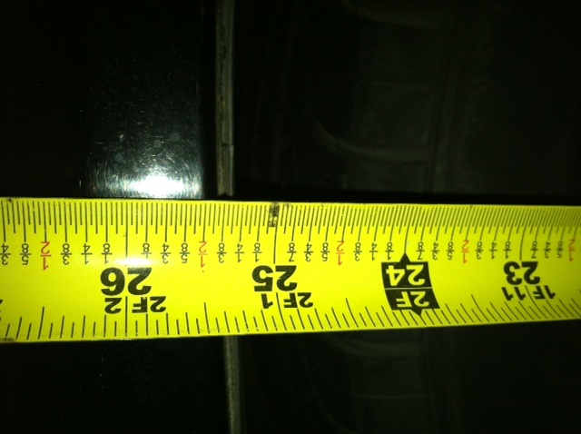

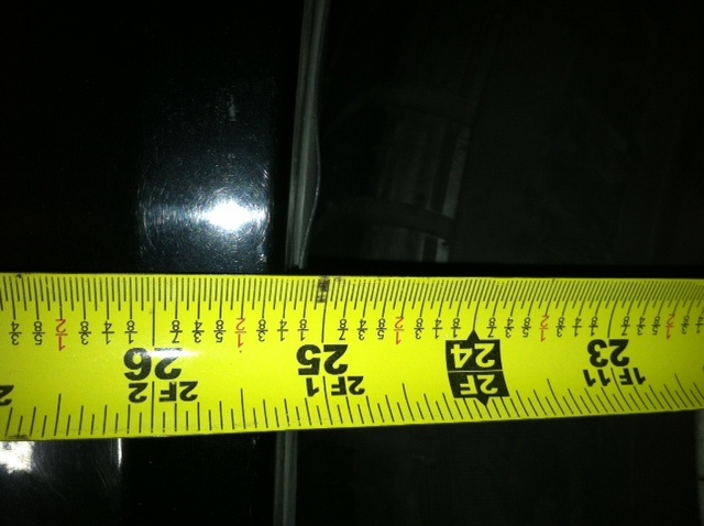

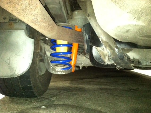

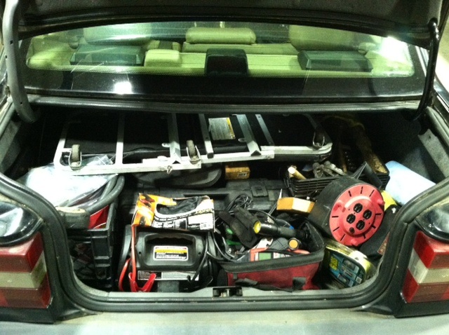

Just installed my IPD rear overload coils with rear Koni STR.T shocks. Drove the first day and noticed significant difference over OEM. Its been about 7 days since i installed them. I carry all my mobile mechanic tools with me everywhere i go, hence why i got the overload vs the drop springs. I noticed today that the passenger sits a bit lower then the drivers side, anyone know why ?
- IPD vs OEM
- image.jpg (138.82 KiB) Viewed 1101 times
- Driver side
- image.jpg (111.63 KiB) Viewed 1101 times
- Passenger side
- image.jpg (100.49 KiB) Viewed 1101 times
- Passenger measurements
25 inch 1/4 - image.jpg (81.81 KiB) Viewed 1101 times
- Driver side measurement
25 3/8 - image.jpg (82.1 KiB) Viewed 1101 times
- All my tools i drive with
- image.jpg (127.12 KiB) Viewed 1101 times

Could it be one seated itself incorrectly on the spring seat? I've always had a hard time with the coils rotating slightly and getting out of the channels when putting things back together.

That looks like the trunk of my Sedan.
I could only imagine Matthews opinion of the springs not being seated exactly the same. Another possibility could be a slight binding of the delta arms after being raised.
Try bouncing the car by hand a few times and listen for a spring sound.
I know it seems funny, and don't let your neighbors see.
It is worth a try. My wagons left spring seemed to pop back into place a few days after I replaced the rear shocks.

Delta arms are funky things. Had something similar after some bushing and spring changes. One day hit a huge pot hole and it "thanked" back into position. In my case the passenger side was high.

Exactly how level is the concrete you're on? This is a hard thing to measure.
Take it somewhere else and see if the measurement changes.
