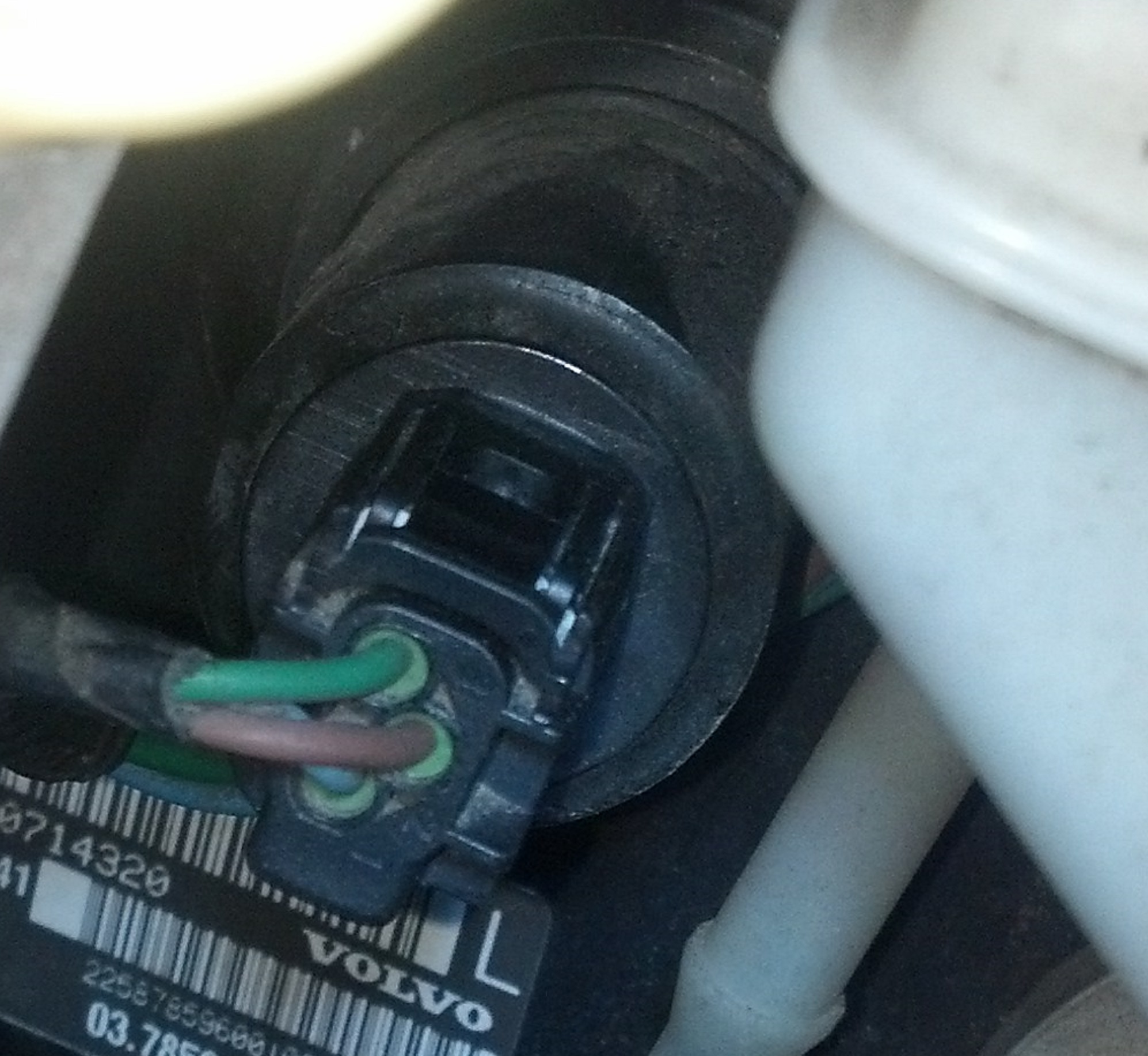

I am interested in repairing the brake pedal position sensor for my 2004 S80 2.9L T6. I have the error message "Brake Assist Service Required" and "Engine Service Required" and I think this sensor may be the culprit. I was trying to follow the repair guide found here: http://www.volvoforums.org.uk/showthrea ... 192&page=5

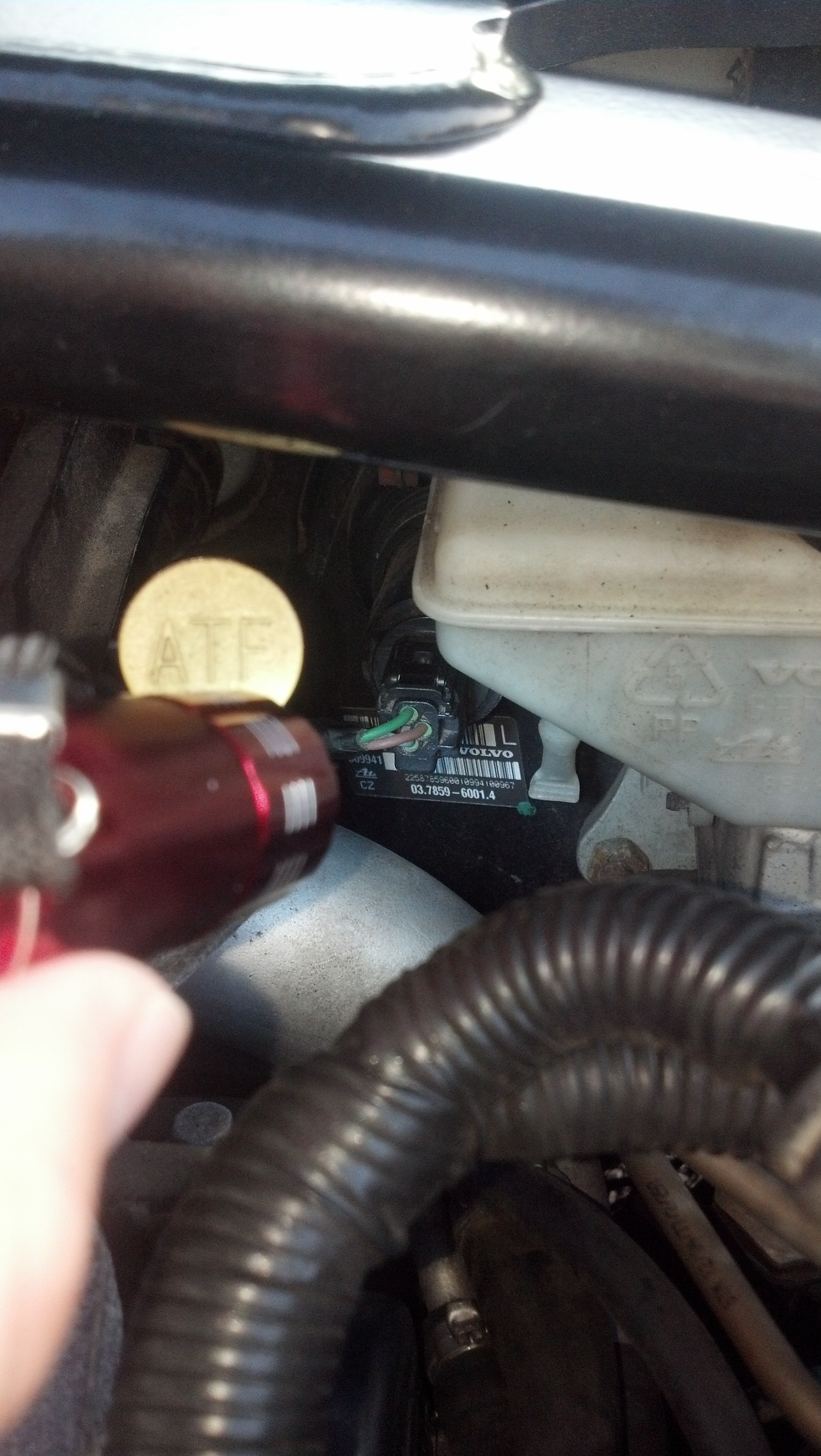

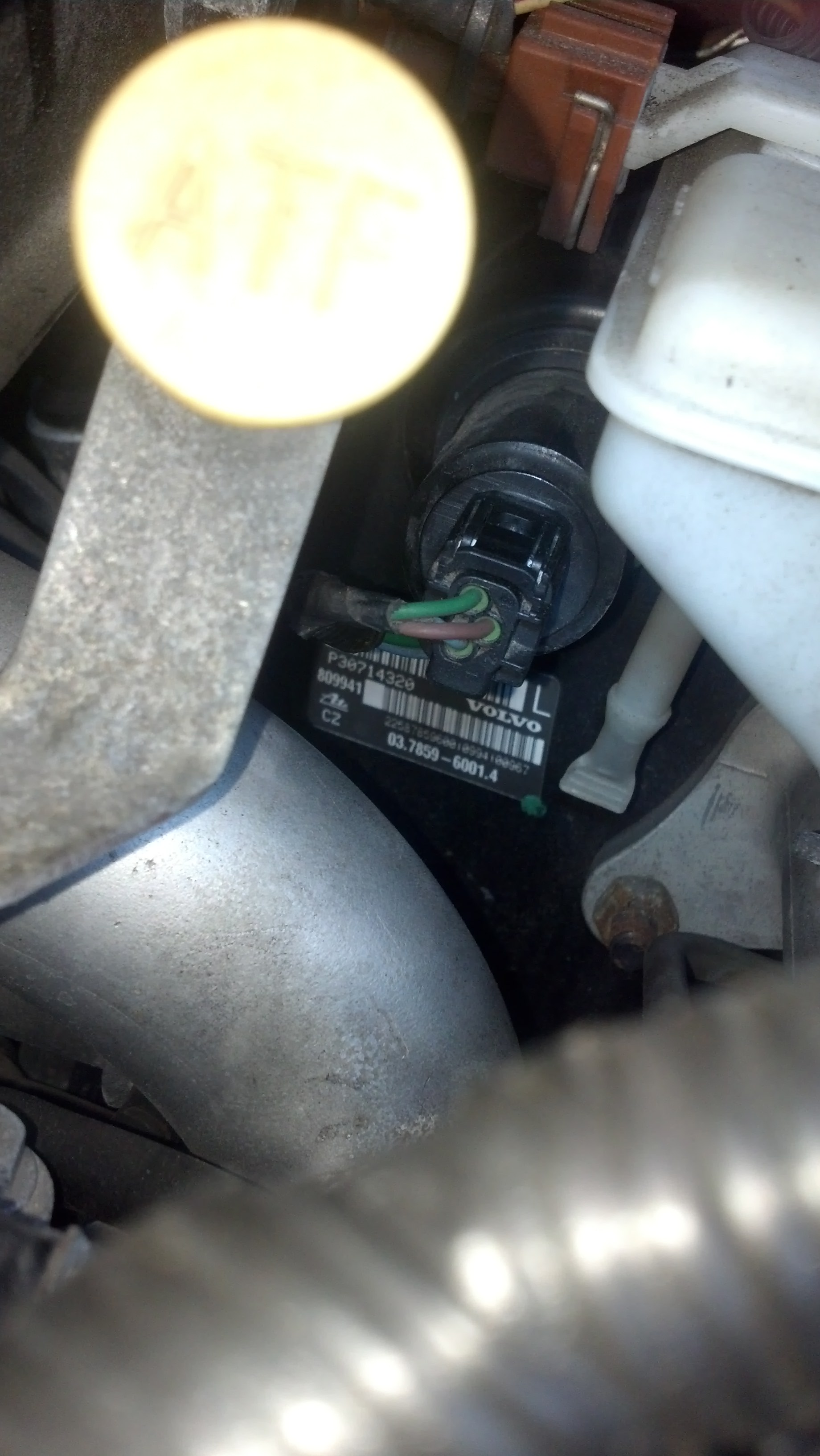

When I was able to locate the brake pedal pressure sensor I noticed that it looked different than all the ones I had seen repaired so here is the picture, it is the first and second attachment. Third picture is to show how tight it is getting in there.
Notice that the plug seems to be in the center of the sensor compared to others that I've seen being off to one side. Also, the end of the plug seems to be one solid piece of plastic that doesn't have the rubber seal that is normally cut into to access the inner workings of the sensor.
Any of you ever came across this type of sensor and repaired it? Do you guys think I would be able to cut this open with a Dremel possibly or might it be different entirely inside? Also, how do you get to the snap ring or curclip that holds this in place, I have no idea how to get in there and get it off? I assume that I remove the strut bar to start but any advice at all would be greatly appreciated!
Close up of BPPS
Close up of BPPS

The three wire versions fail because the potentiometer track wears through. No way to repair that I know of.

So my plug is different than others that are shown being repaired? I noticed the different location of the plug on my sensor but I figured it might still be the same connector.
And opening it up to resolder the joints would fail most likely if I were able to get in without completely destroying the casing? (Because the potentiometer track is just worn through)
I can't even seem to find a replacement online that has the same exact BPPS as mine, most are the same as the ones shown being repaired. Anybody have a clue where to find one that fits or have a donor car?

Two wire ones are different. They are metal conductors with resistance in steps and aren't really a pot.
