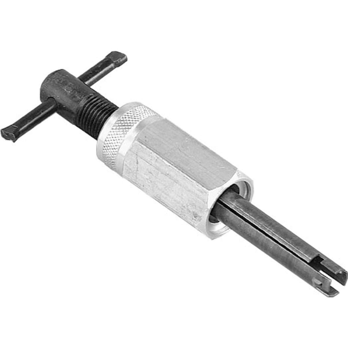

You can grab the end of the orifice tube and pull. If stuck some needle nose vice grips or a drywall screw through the middle and some persuasion normally gets it out for me. An orifice tube removal tool is available as well at around $15 ( The drywall screw is not a safe way to do this -some of us old mechanics do silly things and we know better) . Please don't scratch the area inside the tube where the o rings would seal or slide over to get to that position.

Does the orifice tube stick out enough from the A/C pipe to grab it with pliers or a vice grip? or is it completely inside the pipe?
Is the orifice tube stuck inside the A/C part of the pipe that connects to the evaporator? I have that end of the A/C pipe disconnected because I am also replacing the evaporator. This would make it easy as I could hold the pipe with the orifice tube inside in any orientation and attempt to pull it out.
- Posts: 36154
- Been thanked: 4071 times
On my 1999 the tube is removed from the AC line running right in front of the timing belt with two large (19mm) union nuts. Break the union, then just pull the tube out with needle nose pliers.
Note orientation, I put it in backwards the first time
