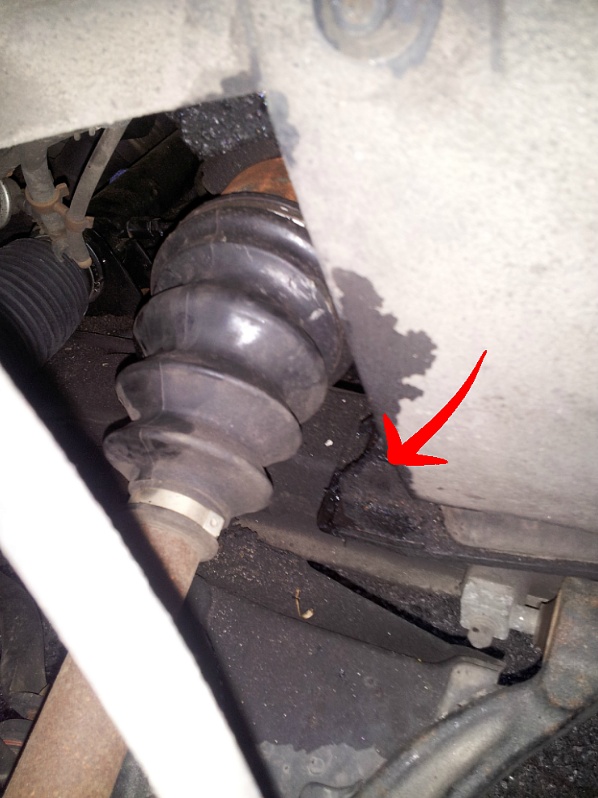

Thanks. I checked the CV boots and they seem fine. The boots were fine and intact. There was some really think grease on the joint shown in the picture. The pic shows the outer side boot on the passenger side and where the grease was. The boot didn't have any visible tears and I felt all around it and didnt feel anything.

Check the control arm ball joints.
The grease/oil leak in the photo above:
- ? Old grease from previous CV Boot leak
- Leaking oil from oil cooler lines
- Anyway, clean the grease/oil stain and monitor it.
