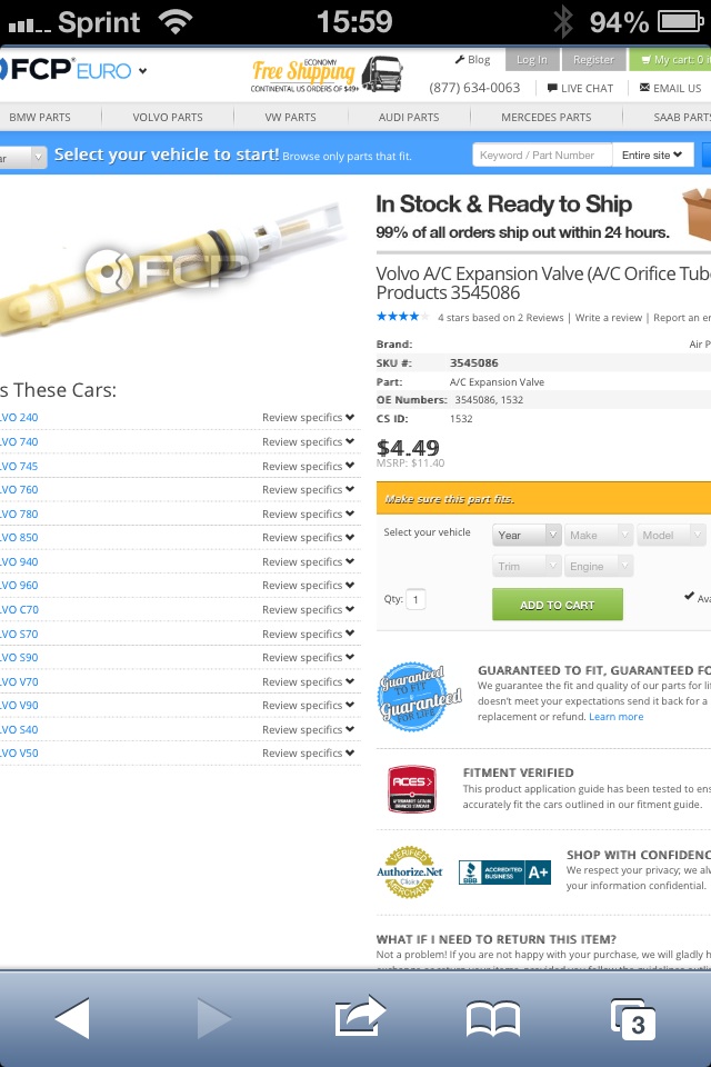

You might want to call FCP on the orifice. That is way more than volvo dealer price on that. It is an orifice and not an expansion valve on that car. Orifices are generic and come in a few orifice opening sizes depending on the car. As I recall 3mm is the Volvo size. Anyway, they are $1.99 at O'Reilly's if that gives you an idea how far off that price is.
The other items are priced well is why that sticks out as so wrong.

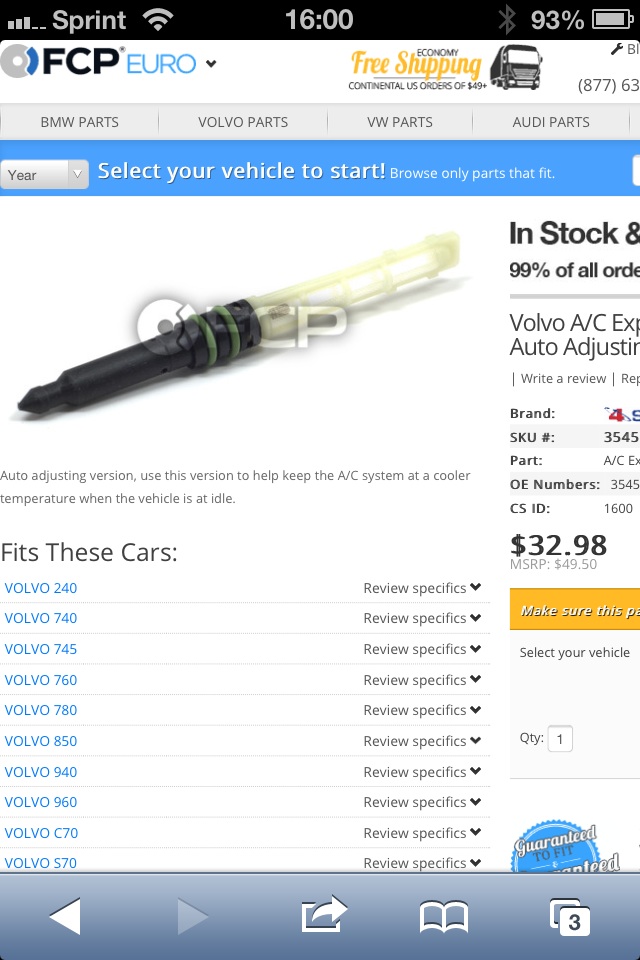

Baptiste1106
- Posts: 206
- Joined: 17 October 2013
- Year and Model: 850 1994
- Location: Brooklyn NY
- Been thanked: 2 times
@jimmy57 .... They sell two orifices, but the one posted is suppose to be auto adjusting. Look at the photos
- Regular orifice
- image.jpg (167.27 KiB) Viewed 241 times
- Auto adjusting
- image.jpg (147.63 KiB) Viewed 241 times
