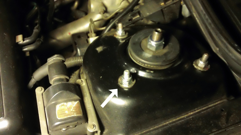

Matt makes a point.
Would you post a photo SimLyons.
A flipped star nut would add to the spacing - a correctly installed example below.
correctly installed...
