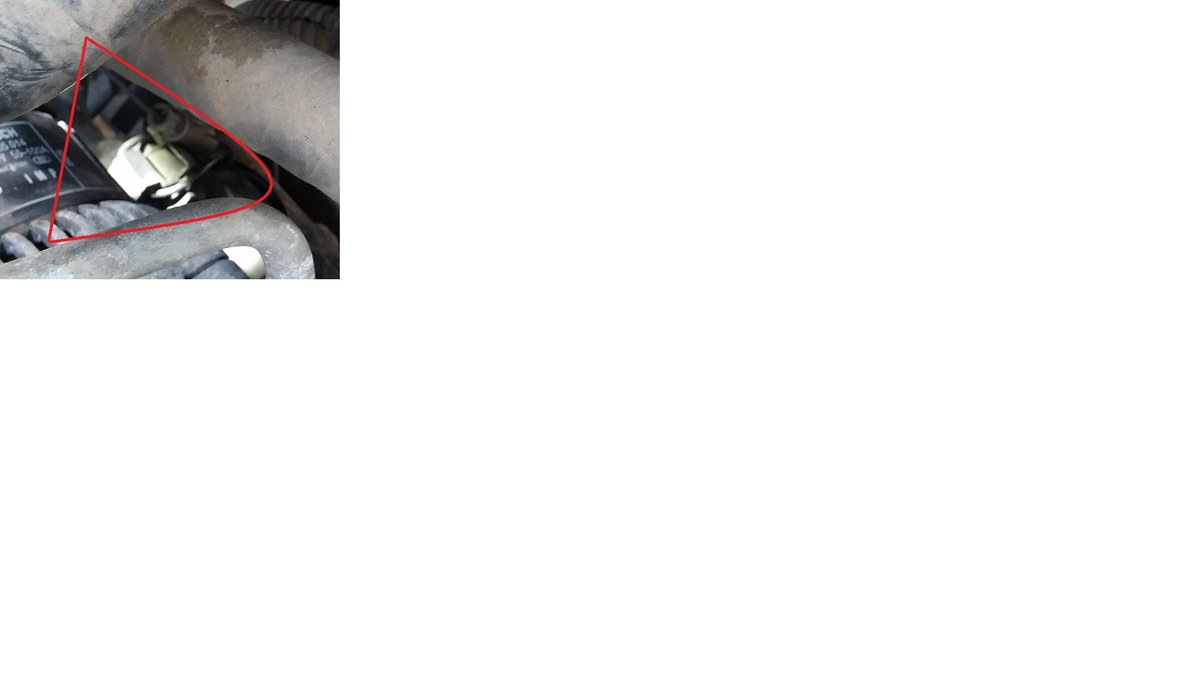

I have a 1998 S70 non-turbo and am currently trouble shooting the AC Comp Clutch.
1.) If i manually slug the AC relay the clutch engages and the pressure is good
2.) Jumpered the Low Press. Sw and had no effect
I read about something at the compressor that could be by-passed for testing purposes, but not sure what or where it is. If some one on the site could point me in the right direction I would be most appreciative. I have included a picture of the only wiring I can see coming off the clutch would like to find out what it is.

Thanks for the tip, my compressor does need shiming so I will do that this evening. However does any one have a schematic of that portion of the electrical. I have jumpered out the Low pressure switch,
The High pressure switch with no luck. I have read that the compressor relay gets a ground from the ECU to energize it, but it goes through several sensors to get to the relay. I have 12vdc every where I should on the relay, but am definitely missing the common for it. Any advice and direstion would be most helpful. Thanks
