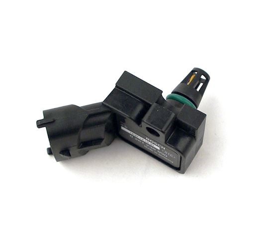

Jimmy57, what are your thoughts on the boost pressure sensor(BPS). Looks similar to the fuel pressure sensor(FPS) which has a very high failure rate. Should I replace this at the same time?
Reinie
Posts: 55
Joined: 17 February 2009
Year and Model: 1999 S70
Location: stillwater, mn
Post by Reinie »
