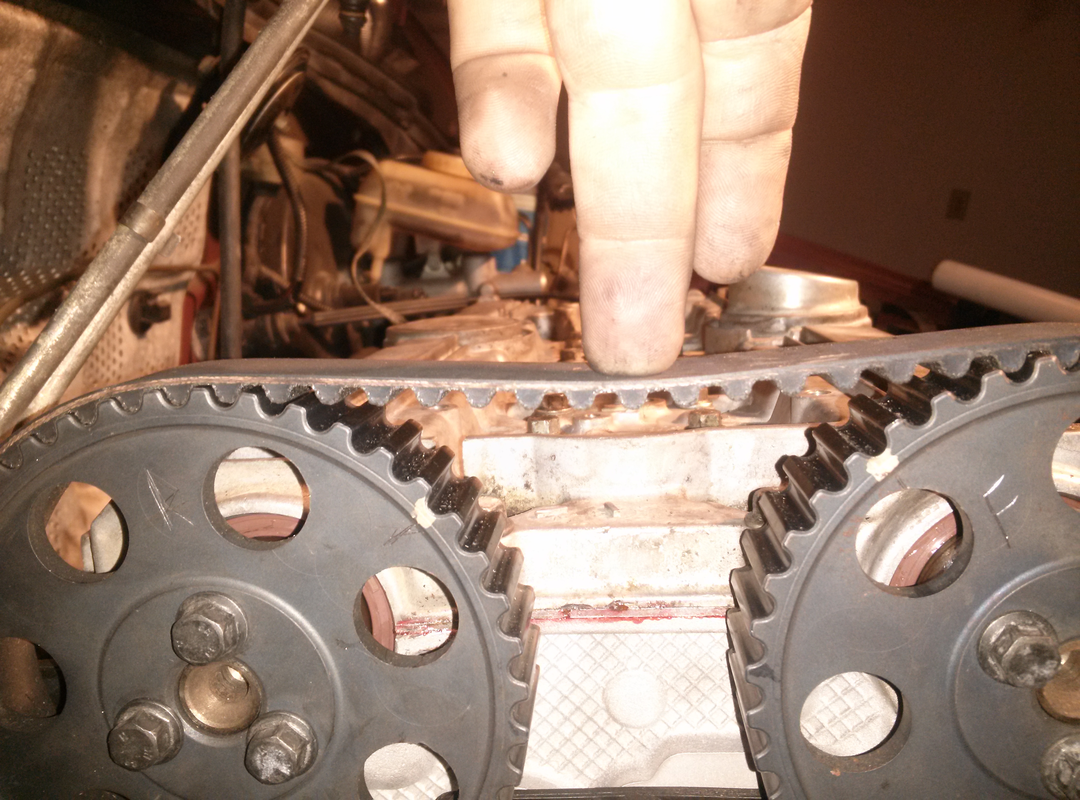

So, I commence the task of installing the timing belt on this headache, and I cannot for the life of me get it to go over the tensioner pulley. I have triple checked the belt part #, and it is correct.
This is as close to achieving my goals as I can get. Best pic I could get..

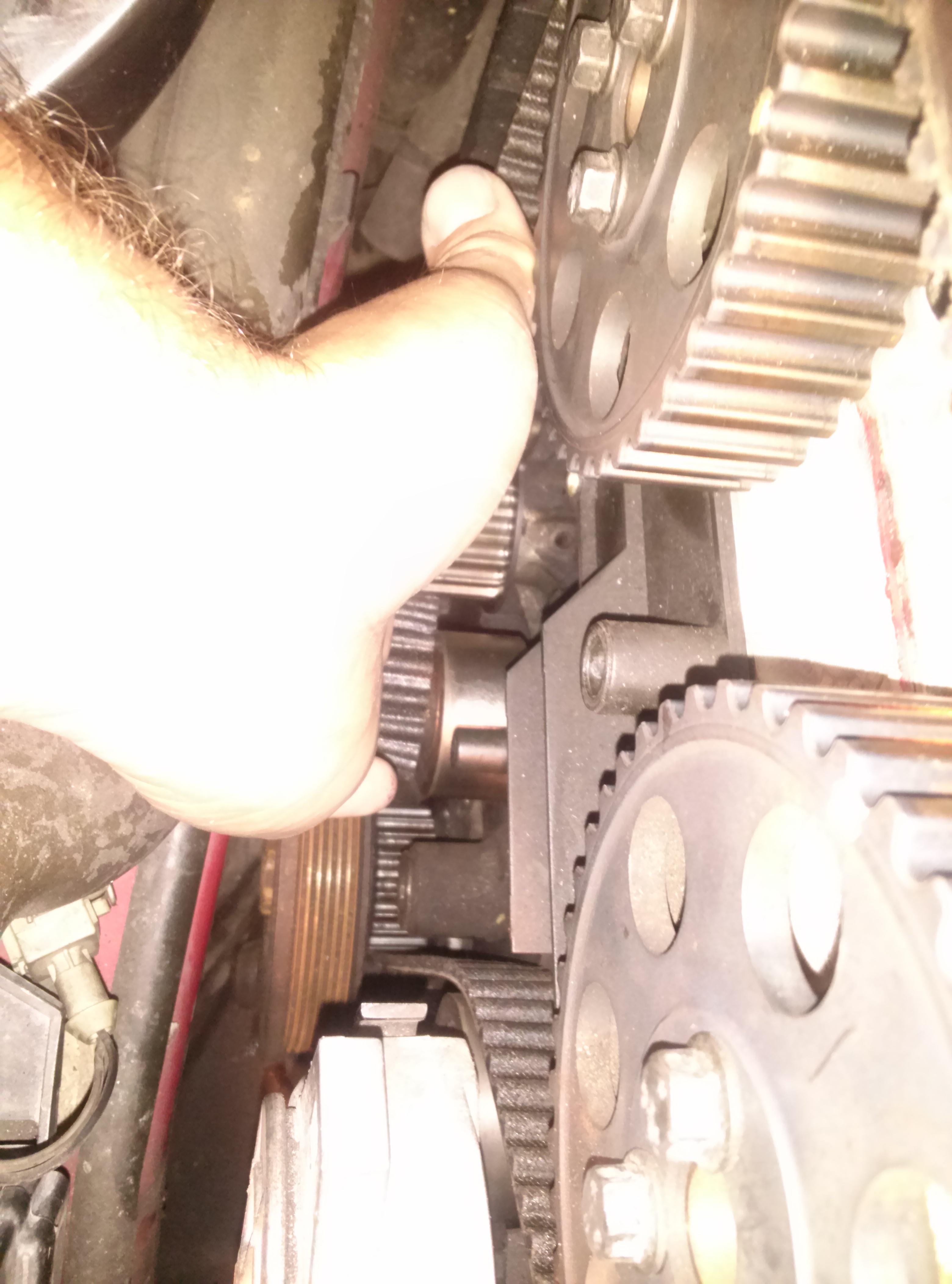

And this is the amount of slack I have between the pulleys.
The tensioner pulley body is as far down as it will go, and it is hitting a bolt for the water pump. I don't recall from my n/a car if this was the case, but I did that one 3 years ago.
What am I missing here? If I was really close, I would mess with the belt a bit, cuss and get it on there, as I had to do on my n/a car. I might try another belt from the pats store to see if FCP gave me a belt that was boxed wrong.

What is the belt number? You may have an early style belt.
...Lee

That should be correct according to the cross reference. Are you sure it has cleared the casting mark below the crankshaft sprocket? That one is very hard to see and it will definitely mess things up.

From the look of the photo, you might want to start by putting the top TB cover back on to check the V marks to see if one of the cams has moved a bit.
I have never routed a belt in the manner you are attempting. I have always done it the vs Bay 13 way of getting it completely routed down below, then hooking a bungee in the tensioner roller to apply upward pressure. Then pulling the belt as tight as possible up the right side, working it over the intake pulley, and maintaining it taught, finished up by working it onto the exhaust pulley so that all possible slack is on the left side before pulling the tensioner pin.

Are you sure you got the belt against the crank (past the dampener) on the bottom of it? Go to 3:20 on this video.

dosbricks wrote:From the look of the photo, you might want to start by putting the top CS cover back on to check the V marks to see if one of the cams has moved a bit.
I did notice the marks were off a bit, so I corrected that. I will try the bungee method tomorrow and hopefully that will lead me to success.

I just did my timing belt last week. It was the fourth 850 T-belt I've done. I had trouble getting the belt to sit proper on the crank pulley. There is an aluminum boss with a rubber donut on it. I rekon it's a guide or retainer for the t-belt. Well, the donut had worked loose and was stopping the belt from sitting on the crank pulley.
Get under there and feel the crank pulley & belt from underneath with your fingers. Make sure that the belt is sitting on the pulley
