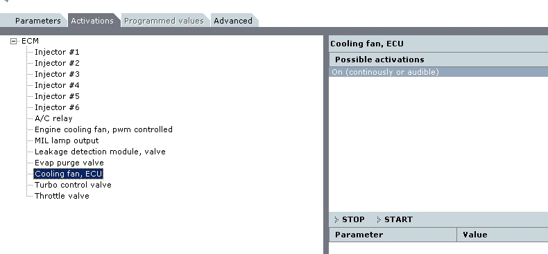

Regent
I tried again and this time I got lost;
A/C relay is always on
when I click on cooling fan ECU this is the screen (on!)
> cooling fan
> cooling fan
monday 84 a.jpg (55.01 KiB) Viewed 1454 times
and when I click on the fan > start this is the screen I get
Everything goes gray and there is no sound from the fan.
start stop
start stop
monday 84 b.jpg (60.03 KiB) Viewed 1454 times
this is not what I got earlier this morning
Maybe I should re start the engine run a few minutes turn all off and wait a little bit more?

Post by regent »
Sergio,
I think you should run the activations test while the engine is not running and ignition key in pos. II
Please try again
BTW, this fan is controlled by the ECU via pulse width modulated signal sent to the fan control module, which is an integral solid state device (not the old school EM relay)
