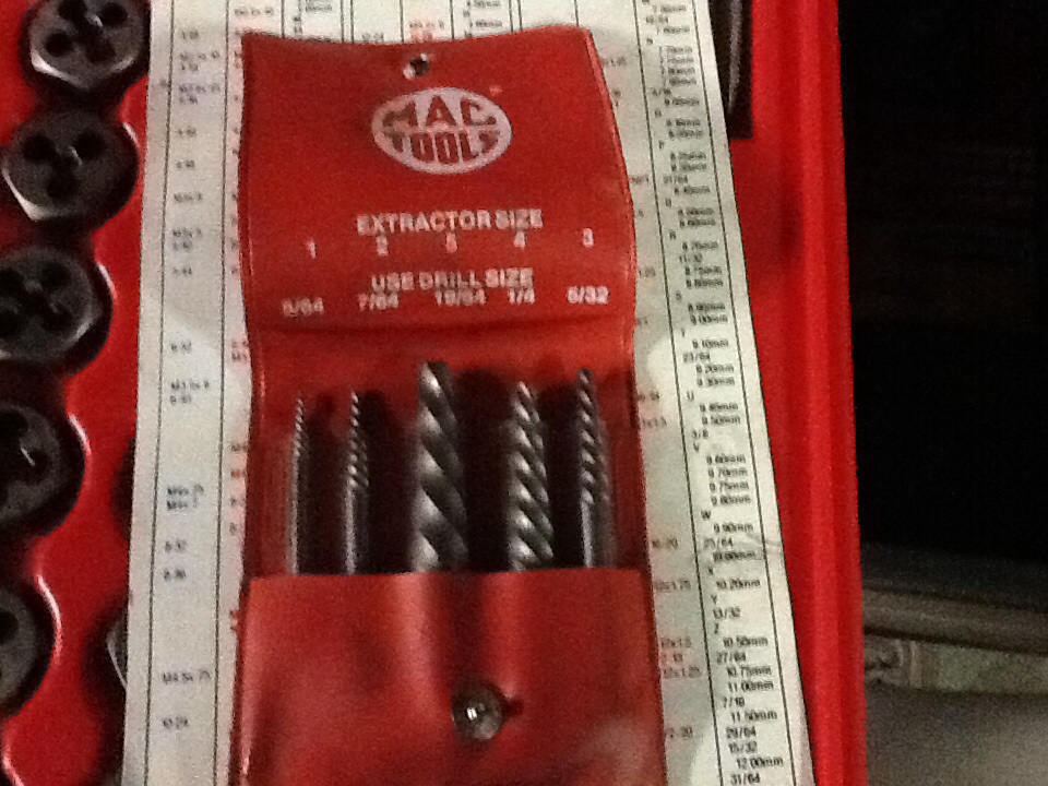

last week I had to drill out the 10mm wheel sensor bolt on a spindal. I used a cobalt bit. I ground smooth the broken bolt, then with a punch tagged the center then drilled. kept the bit tip wet with WD40. tried an easy out with no success. kept going up in bit size then used a tap to clean up.

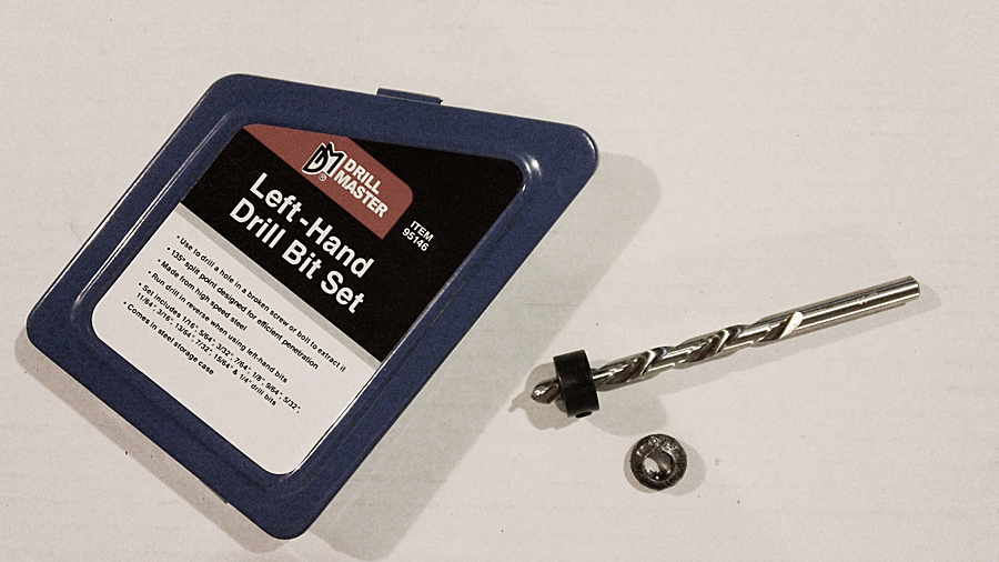

xHeart
- Posts: 3306
- Joined: 3 December 2011
- Year and Model: 2.0/3.2
- Location: Great Lakes - USA
- Has thanked: 113 times
- Been thanked: 115 times
One lesson is to slow it down. Let it soak longer, prepare well, and plenty of patience.cn90 wrote: [...]
- The worst case scenario is drilling straight into the steel stud, it is labor intensive and sometimes you may have to accept the fact that the female threads may be damaged during drilling. This is the scenario I am trying to get at. What is the best drill bit for this?
Getting a starter hole on a machined surface using hand-held in situation you describe is a risk.
But, before a drill bit, a good punch to mark the start point is key to successful start of drilling.
Starting the first hole with a new set of drill bit -- small size first, and then gradually increasing the hole 1/16" or 1/32", and little deeper each time. It goes quickly after the first hole with plenty of oil on the bit. It helps to use stopper.
The thread can be saved by stopping at a dia 1/32" or 1/64" smaller than the thread size.
