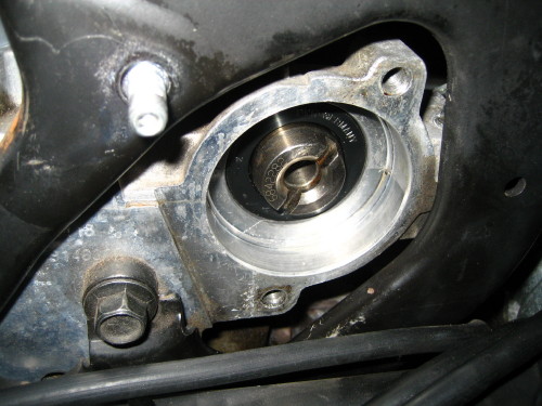

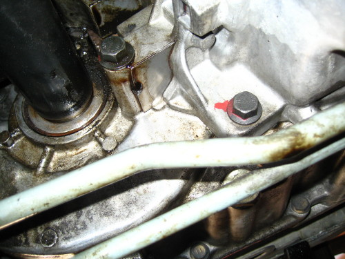

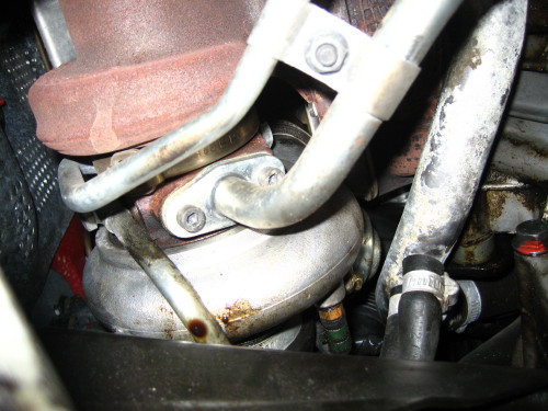

- Oil appears to be coming from high up, behind engine support bracket, similar to cam seal leak.
- Small_0002.JPG (65.04 KiB) Viewed 2680 times
- Turbo oil lines appear to be dry.
- Small_0001.JPG (72.7 KiB) Viewed 2680 times

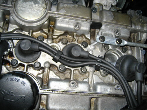

Nothing under the spark plug cover?
What about the bolt here?
That cam cover anaerobic gasket can be a real PITA.

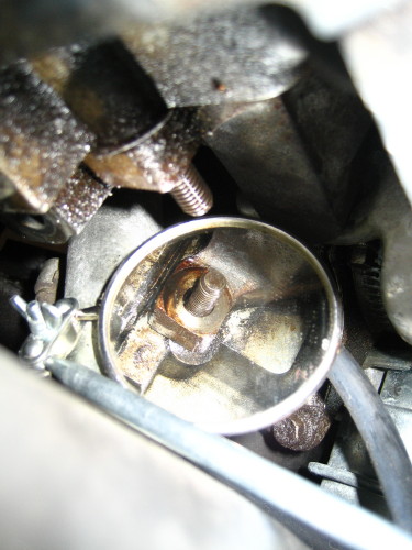

Sorry for disappearing for awhile...I was out of town.

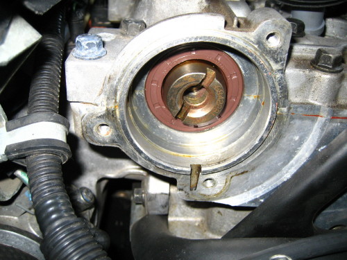

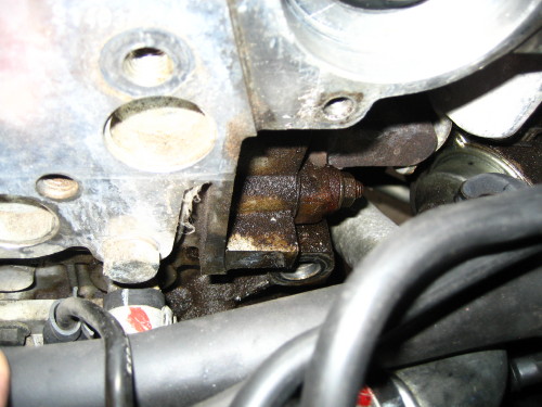

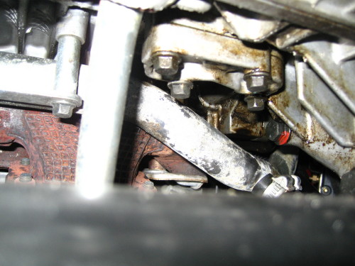

There is no oil underneath the spark plug cover, and that bolt in your photo is dry. Here are some pictures showing the intake & exhaust cam seals are dry. I removed the engine support bracket to get a better look at what's going on. It appears that the oil is leaking from the exhaust stud closest to the driver side of the engine. Here's some photos. The nut was not that tight. The Hayne's manual indicates the torque spec is 18ft pounds. It might have been a little under that. Hayne's also says when reassembling: "Return any studs that were removed with their nuts back to the cylinder head, sealing them with suitable thread sealer."
Does this stud penetrate into an oil passage in the head? Should I try to remove the stud and replace it with "suitable sealer"? What sort of sealer would be suitable? Can I get the stud out without removing the exhaust manifold? Using the "two nut" technique?
For the record, it's leaking about a quart every thousand miles.
What do you think? Thanks for any help!
Paul
Paul

Okay, so I removed the stud using the 2-nut technique. It was rather loose. There didn't seem to be any oil coming from the hole it threads into. I cleaned the stud and the hole the best I could, applied some of that shellac-based aviation gasket maker to the stud--I had it on hand--and put it all back together. We'll see how it goes...

I just wanted to report back with the results. Either tightening the stud, or the gasket sealer, or a combination of them both did the trick. It's been a couple thousand miles and my car is leak free--at least for the moment.
So we can add this stud to the list of possible oil leak sources in the "above the turbo" area of the engine.
Thanks to everyone for all the suggestions.
