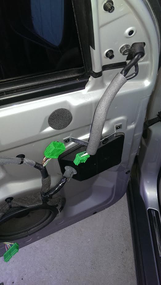

So I went to a pick a part place to get some new old mirrors for my 2000 S80 2.9. When I bought the pair and attempted to install them I was surprised to see that the wiring harness was different and incompatible with the ones i picked up at the pick a part place. I will be going back to the place to check what year the S80 T6 was that I took the part from.
Does anyone know why they could be different and if I might be able to redo the wiring on the to make the other mirrors fit into my wiring harness set up?

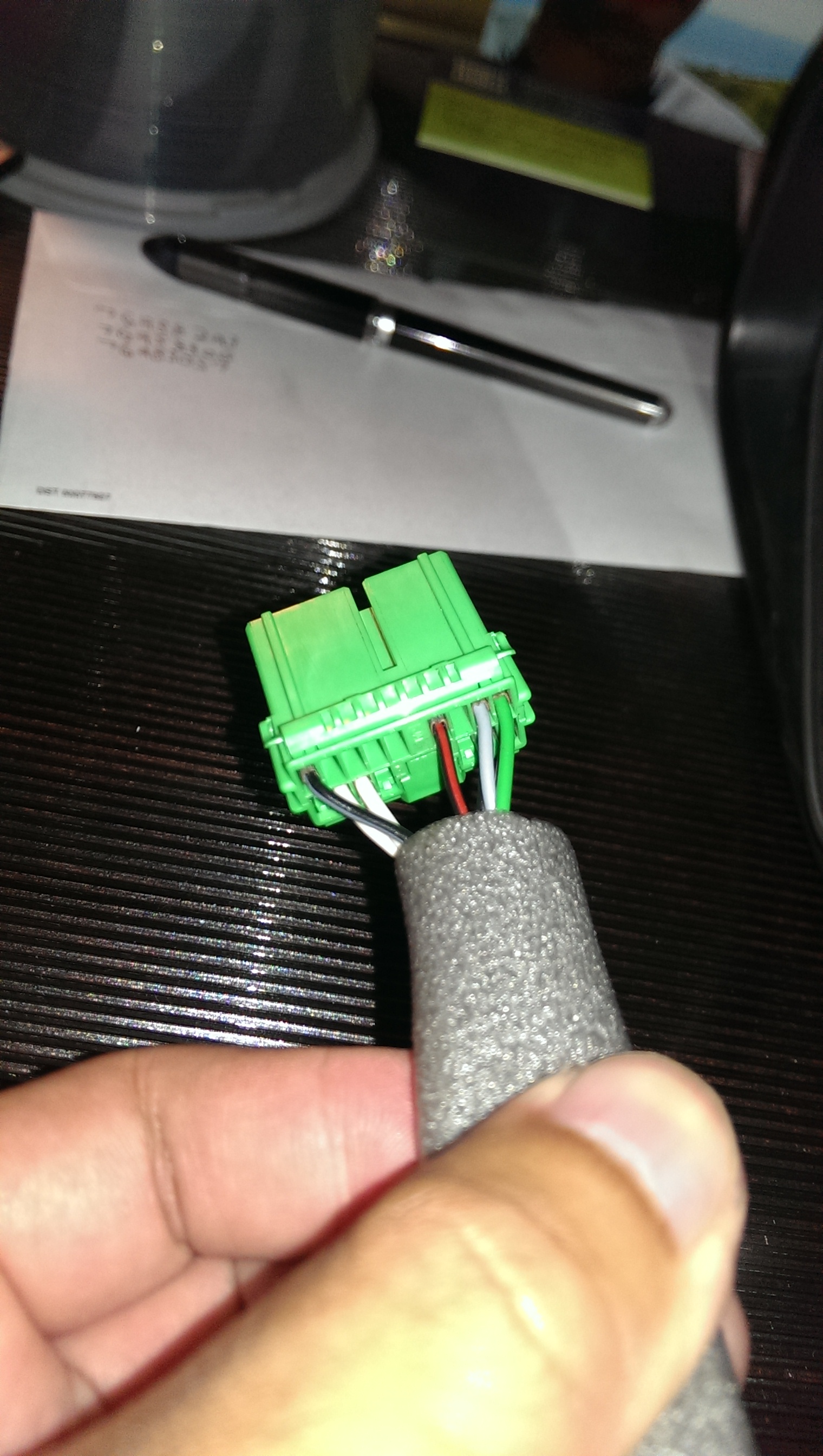

The wire counts are the same with a two different color wires. Not sure what would happen if I were to switch the connectors with the two different colors and install on my car? I'm only keeping them as spares for now. The S80 T6 that I took them off of was a 1999 and I have a 2000. Just not sure why Volvo would use different color wires and connectors for the same model car with only a one year variation difference.

I had the same problem, I have an S80 from 2000 and bought a mirror from 1999. My mirror had a 16-pin green connector and the one that I bought a 10-pin grey connector. I took of the mirror glas and put in the motor of my old mirror (don't know if it's necessary), and soldered the green connector to the new mirror like this.
