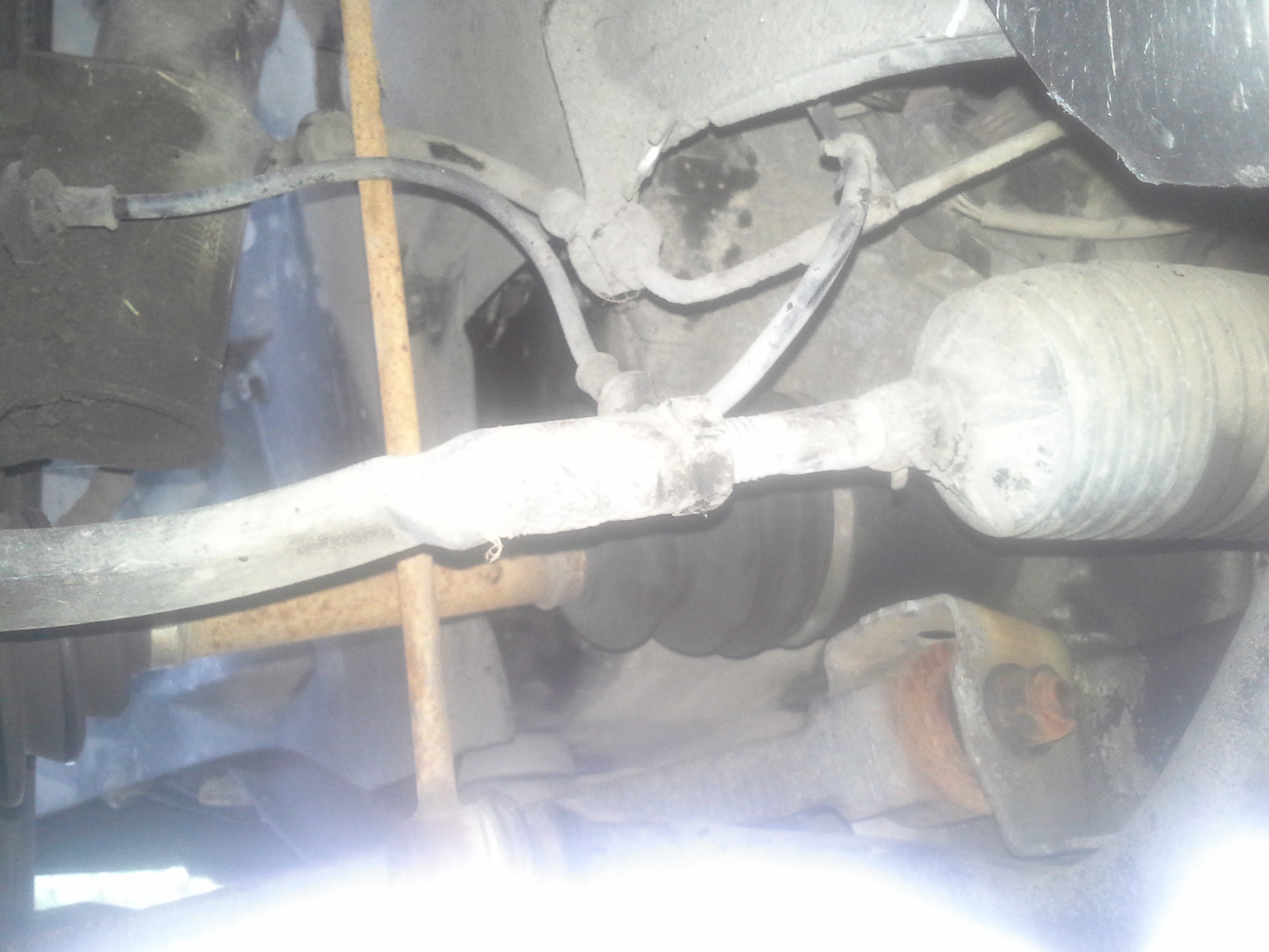

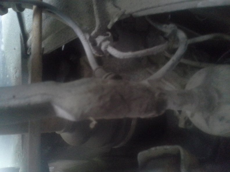

Thanks for the input! But thats where ive ran into a road block; there is no notch on my inner tie rod? Would it be underneath the boot? Theres about an inch and a half between the inner tie rod boot and the outer tie rod lock nut?

There's a 13mm hex on the inner tie rod. If there's no hex, just use pliers.

Yes turn the inner tie rod to adjust toe-in. You will need to heat with propane torch and use some PB Blaster because by this time the threads are seized in there (water, salt from winter etc.).

Ok so I need to pull back the boot to find the notch or just take pliers to the open portion of the inner tie rod? The reason I am trying to align is that ever since I bought the car it has pulled hard right and thr INSIDE of my FRONT DRIVERS SIDE tire is wore way down. I rotated the tires from rear to the front and within a matter of days that tire was wore down on the inside as well. I measured yesterday using both string and tire line trick. What I came up with was an 1/8th inch off on both left and right tires, a 1/4 inch total.

If you have a significant pull and wear, then there could be a component that has been bent and the pull may remain even after your adjust the toe. Have you ruled out a bent control arm?

This.
everything looks pretty old in there. check the inner & outer tie rods and the ball joints
