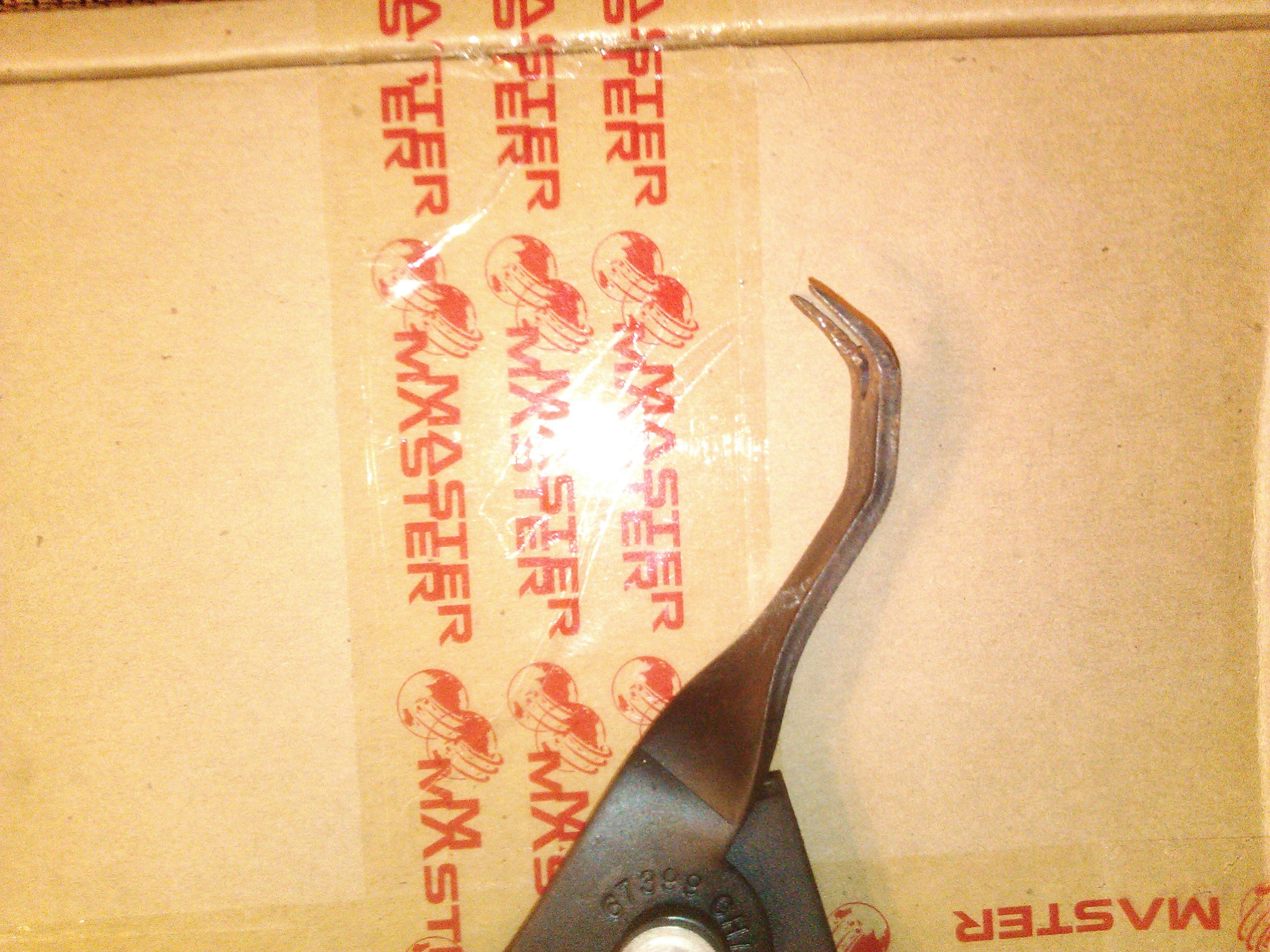

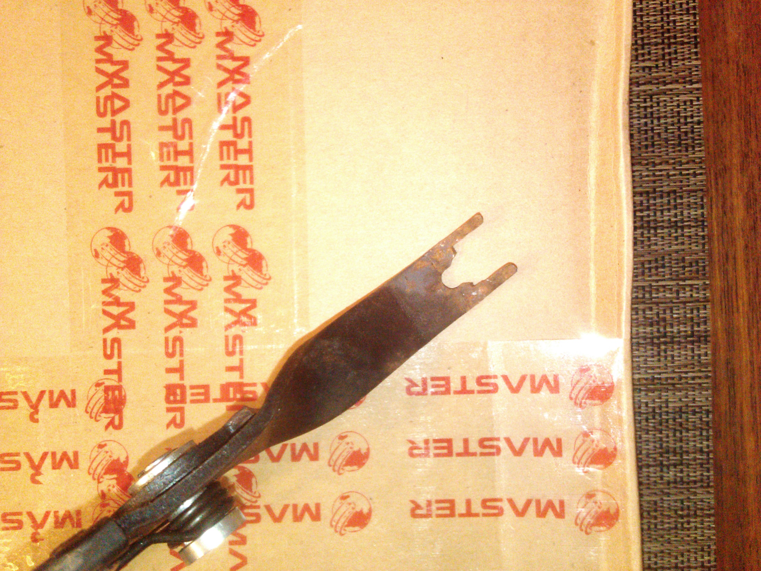

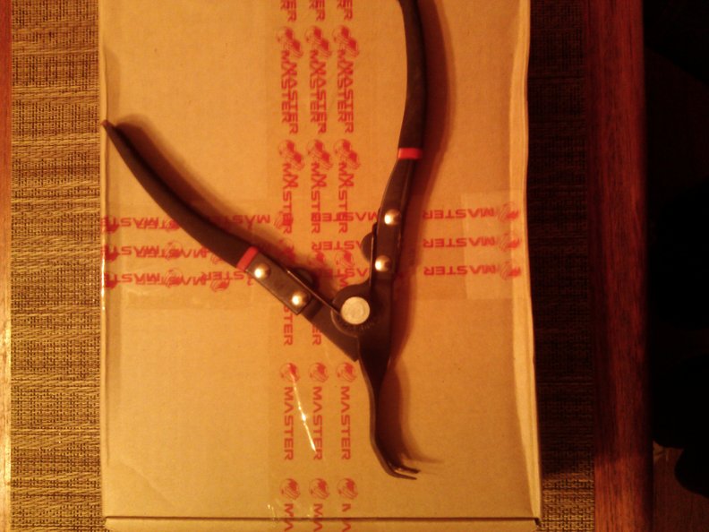

That's for the info. I'm going to try it what have I got to loose. I'm not sure about the tools that he was using but I will take the pic to with me to try to find it. I've got the tools just not clear about when I'm taking it out about the fuel lines? Do you know if the lines are quick connects like the fuel filter our something else? I did get lucky on the starter I bought a new on in 07 found the ticket so I don't have to buy that. Thanks so much for the link that you sent me.

The lines are a quick (or not so quick) connect. I bought the same tool but I wound up making it a bit differently. Here are some pictures of my version.
What you do is maneuver the tool below the clips on the fuel line connectors and then just pull straight up.

I have a die grinder. I bought some cutting wheels. Do you think it could be cut with out dropping the tank and do you know what side to cut. Is it the driver side rear. Not sure about the pic. Where did you find that tool. I have a snap ring tool not sure what that tool is called you are using. I will be busy Saturday first the starter then the fuel pump. I hate my car..

The tool began life as a Harbor Freight interior panel removal tool, I think they call them panel clip pliers. The fuel pump you want to change is the one on the left, passenger's side.
