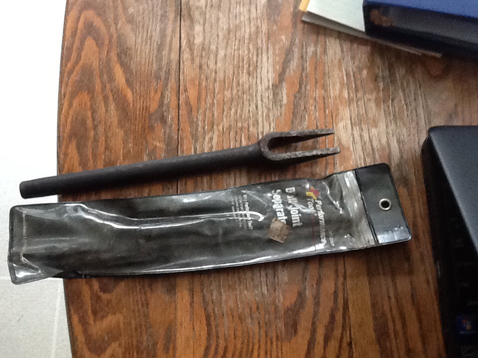

Autozone will rent you the 'pickle fork' tool above I think
