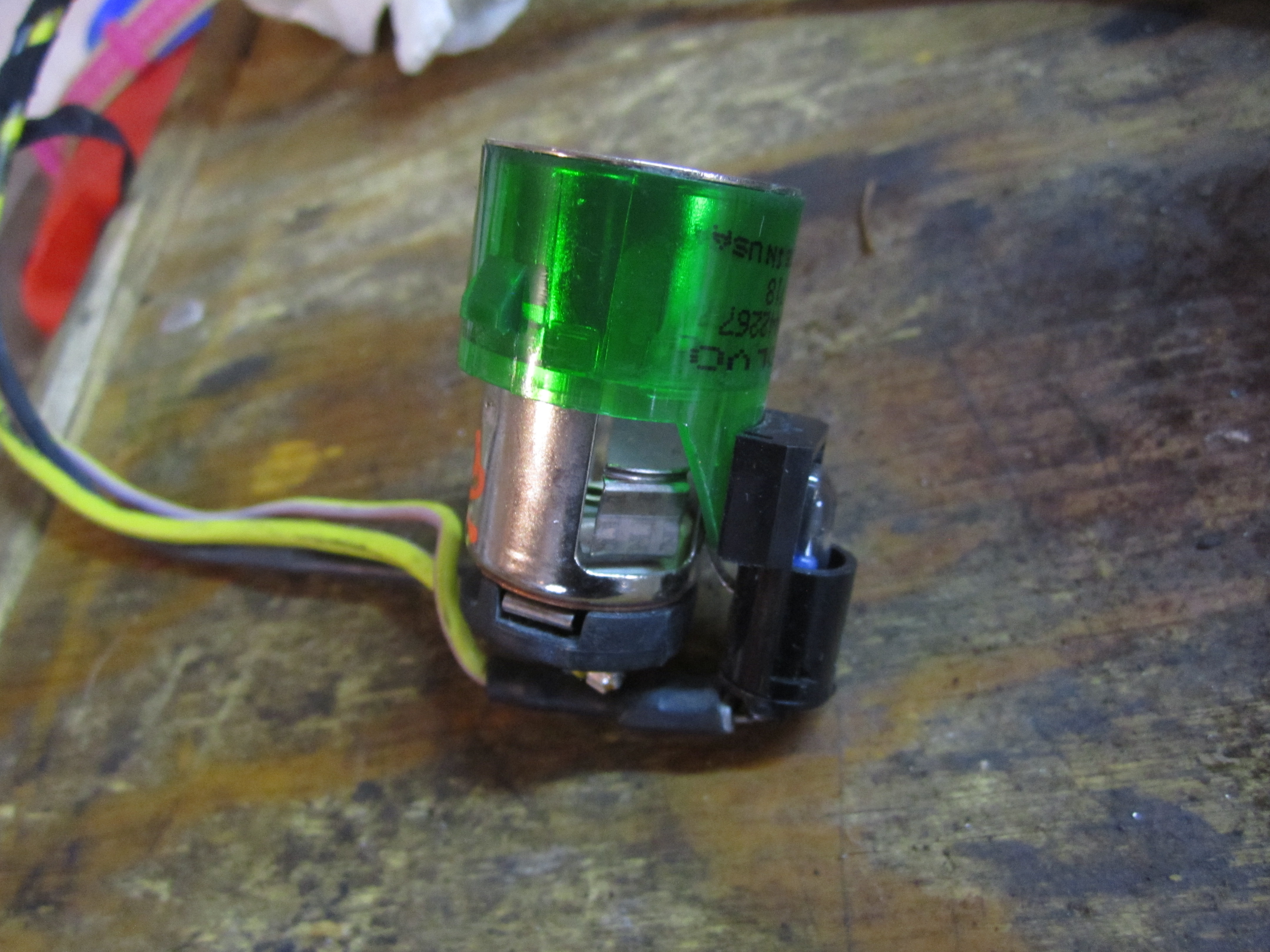

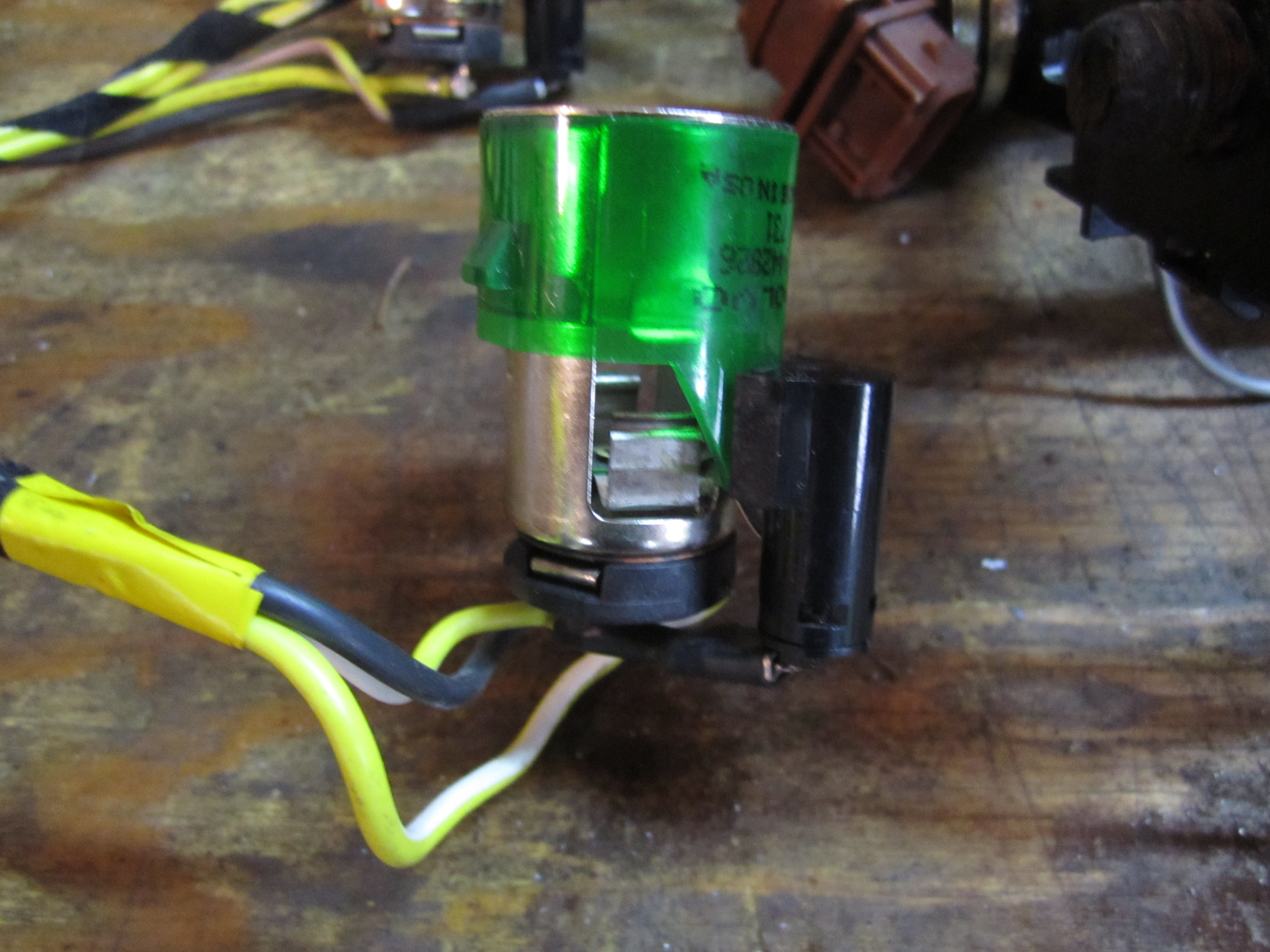

3) 12V socket in the center dash and rear garbage bin. I pulled 2 as spares, as for some reason both in my car are fairly corroded in their contact points. Is there any way to test the bulbs on the bench, and if the bulbs are duff, how do you remove the black housings to replace the bulbs? Also what are the bulb specs.?

The bulb holder comes out if you twist n pull.

3) Which part do you twist? If I look carefully there a 3 cut-outs on the side of the bulb holder, one with a barb. I have managed to break part of one holder trying to twist it and no luck. The other one opened easily, but not quite sure how I did it. With careful prying, I was able to get the whole black portion to snap of the side of the green housing without breaking anything. Do you know what the bulb rating is?

I think you're seeing the bulb melts socket to receptacle problem with the cig lighter illumination.

I got both of the lighter units up and running with new bulbs (12V 1.2W) that I discovered in my garage. I will install these when I start a push on final dress up repairs prior to selling this car (not using it enough and getting too much damage parking it at work in retail). I'll pull the center console for that.
