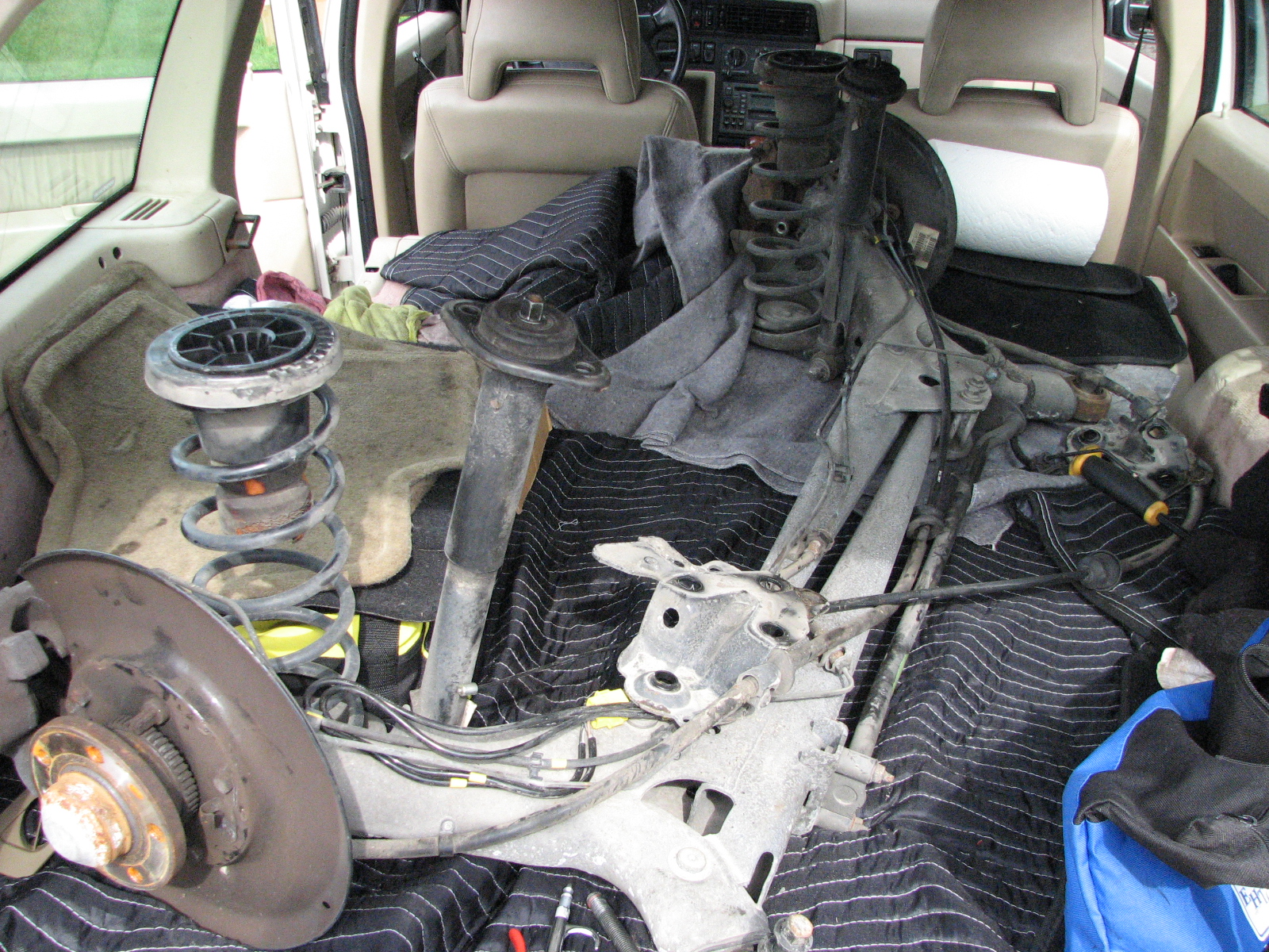

I am going this way for the replacement I plan to use that I had fortunately come across at the yard.
All of the bushings are likely shot in the 20+ year old car, especially after the last winter here.
It will take care of upgrading my '93 sedan to five lug in the rear. as well as not needing the tool...
This came from a '98 S70, of which appeared nearly new.
Addressing the original post,
I was able to scavenge all the bolts, which can get pricey from the dealer, but can be found.
FCP, IPD, and others usually have the needed bolts as mentioned,
Good wrenching.
Good wrenching.
