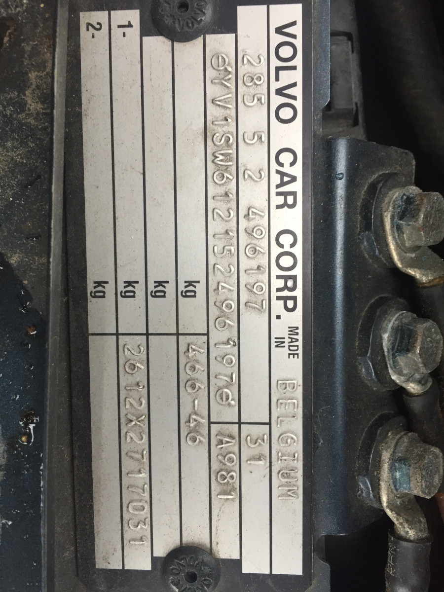

Color code 466 Barents Blue metallic
Engine number

2005 V70NAM56 CATHERINE 496197 Manual 5 into code A981 Saurus 15inch wheels
