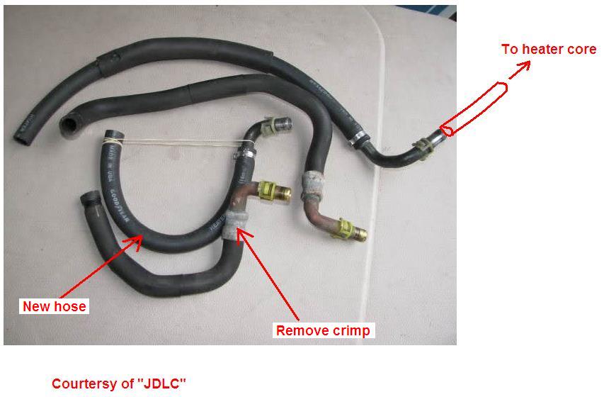

- Wonder if you can install some long zip ties and gently tug the heater hoses away from the engine block?
- Or use the factory elbow: cut the crimp using dremel tool, then install new 5/8" hoses. I took a photo (courtesy of JDLC) and label the hoses so you know what my thoughts are:
http://volvoforums.com/forum/volvo-850- ... nes-46740/

Update: I resolved this. For some reason I posted it in another thread.
https://www.matthewsvolvosite.com/forums ... 84#p350084
Using the elbows resolved the rubbing concerns at both ends. The hose at the transmission no longer rubs.
I purchased barbed hose elbows; the factory elbows are probably fine to reuse.
