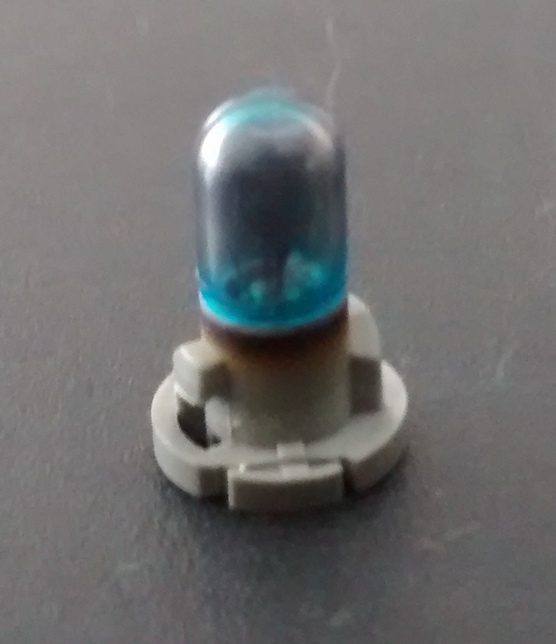

One light behind the climate controls went out. I removed it to ID at at local store (no Volvo dealer nearby at the time) but couldn't find a replacement, so I ordered one https://www.fcpeuro.com/products/volvo- ... b-30739358 from FCP. After a couple days of driving, the whole cluster was out, even after I put the bad bulb back in (the new one had not arrived yet). Does this indicate a fuse issue?

I did some more reading and it seems the bulbs were replaceable up until 2003.
The climate control panel has 4 grey based bulb and 2 white. The bases of all of mine look burned out.

With some help from my repair manual, I replaced the 4 grey ones (I hadn't ordered any white) and they work now. I'll get a pair of the white ones eventually and hope the whole thing lights up then.
