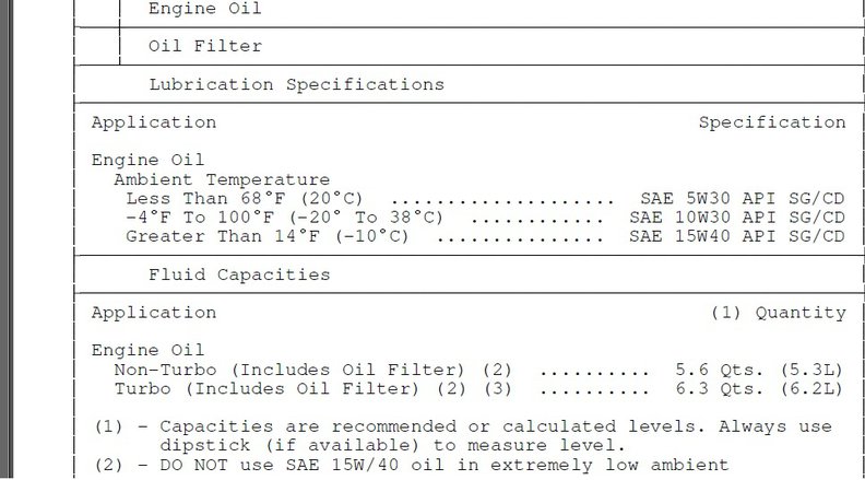

I have run 5W30 synthetic oil in 850's for years, I've never had issues with it being too thin. You can try a heavier weight but I would be surprised if that had effect.
EDIT: In fact, per the service manual, 5W30 is recommended for temps below 68 degrees F which I suspect you are experiencing in Connecticut.
