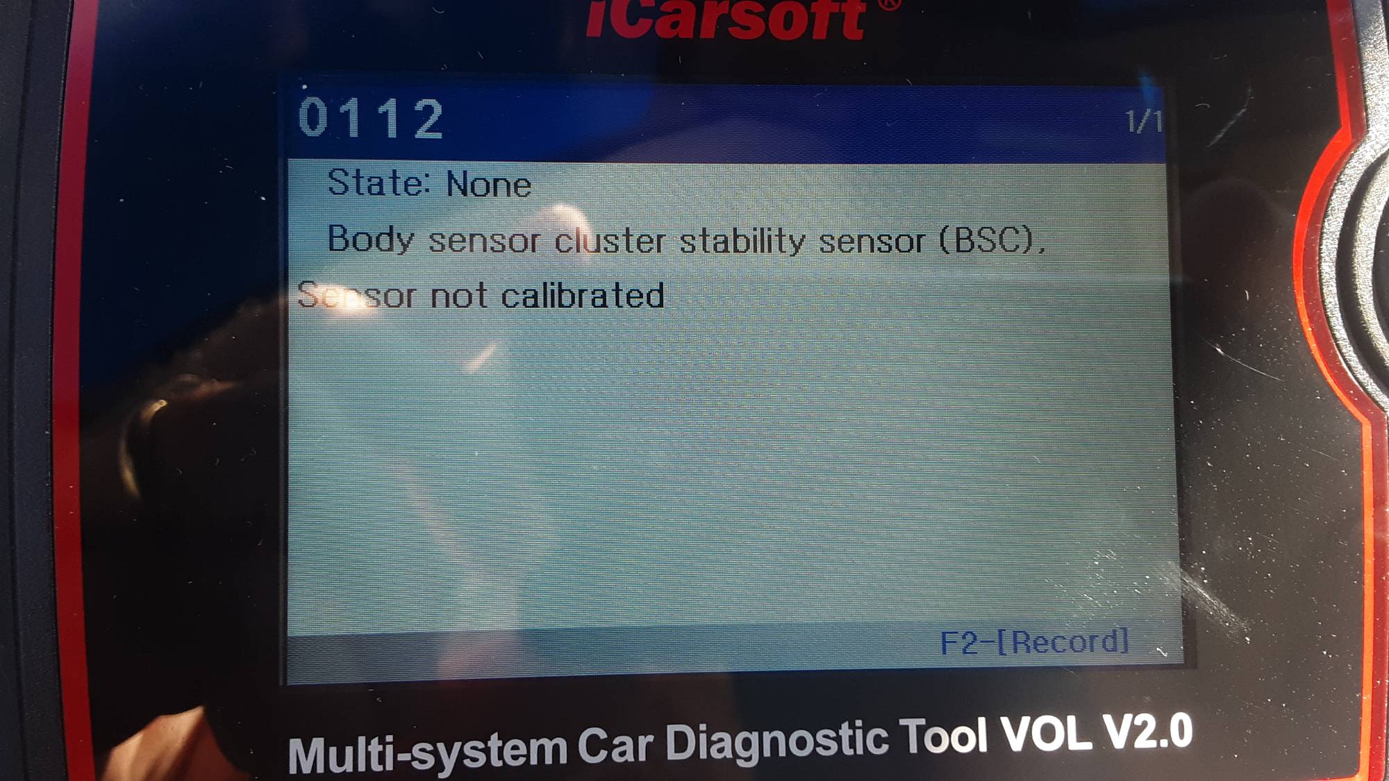

Folks - The Active Yaw Control Sensor (found under the passenger seat and carpet) is a very expensive repair whether you purchase a new unit or send yours off to be re-manufactured by Xemodex or BBA Reman or try to get a used one. Fortunately, I found that BCM (brake control module) codes indicating a failed Yaw Sensor may not necessarily indicate a $500+ repair is on the horizon. In my case, water had not penetrated the Yaw Sensor housing. Rather, water had pooled in the cowling of the plastic electrical fitting that passed through the Yaw Sensor housing. This fitting contains the connection pins to which the harness is attached. Removal inspection showed green corrosion deposits on and in-between the pins. I assume that this somehow shorted the pins and lead to the Yaw Sensor failure codes. I was able to carefully dry and clean the pins and female wire connector, re-install (without the water...more on this later). Clearing and rereading the codes at my Independent shop revealed DTC ABS/BCM [ABS-0012 / Active Yaw Control Sensor, sensor not calibrated] or using Vidas the code becomes [BCM-0112 AYC-Sensors not calibrated]. For under $100, you can have a shop with Vidas recalibrate the Active Yaw Control Sensor...actually its called Reprogram Anti Skid Function. That's the short version for those who have researched the blogs as I do. More detail follows for those who do not.

With my unit the codes at my Independent Tech became ABS/BCM ABS-0112 / Active Yaw Sensor, Sensor not calibrated/. And at the Tech with Vidas BCM-0112 sensor, Sensors not calibrated.
>>Have the Vidas tech perform the Anti-Skid Reprogram to calibrate the Active Yaw Sensor. The codes cleared and Anti-Skid worked!!

Question for the community on this old post. Last electrical gremlin I am clearing from my new to me 05 XC90 2.5T is a Anti-Skid message and 0112 code saying calibration is needed.
My question: My independent shop says I need to go to the dealer to do this. I'm certain they have VIDAS as they specialize in Volvo...does this make sense? They mentioned something about the software needing a connection to the Volvo mothership they don't have.

VIDA and a DICE will do this. A number of years ago I did not wait long enough after shutting the vehicle down before disconnecting the battery and somehow came up with an invalid sum value in the yaw sensor which required a recalibration. I did this successfully using my own VIDA and DICE. Per VIDA- Calibrate as follows: VIDA\ Vehicle Communication, select BCM module (Advanced tab)\ then select Calibration (only vehicles with DSTC).
