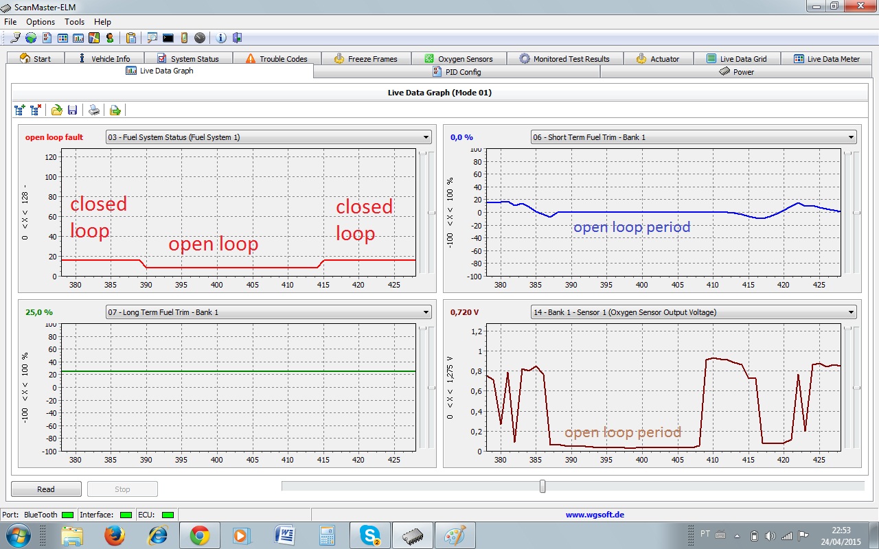

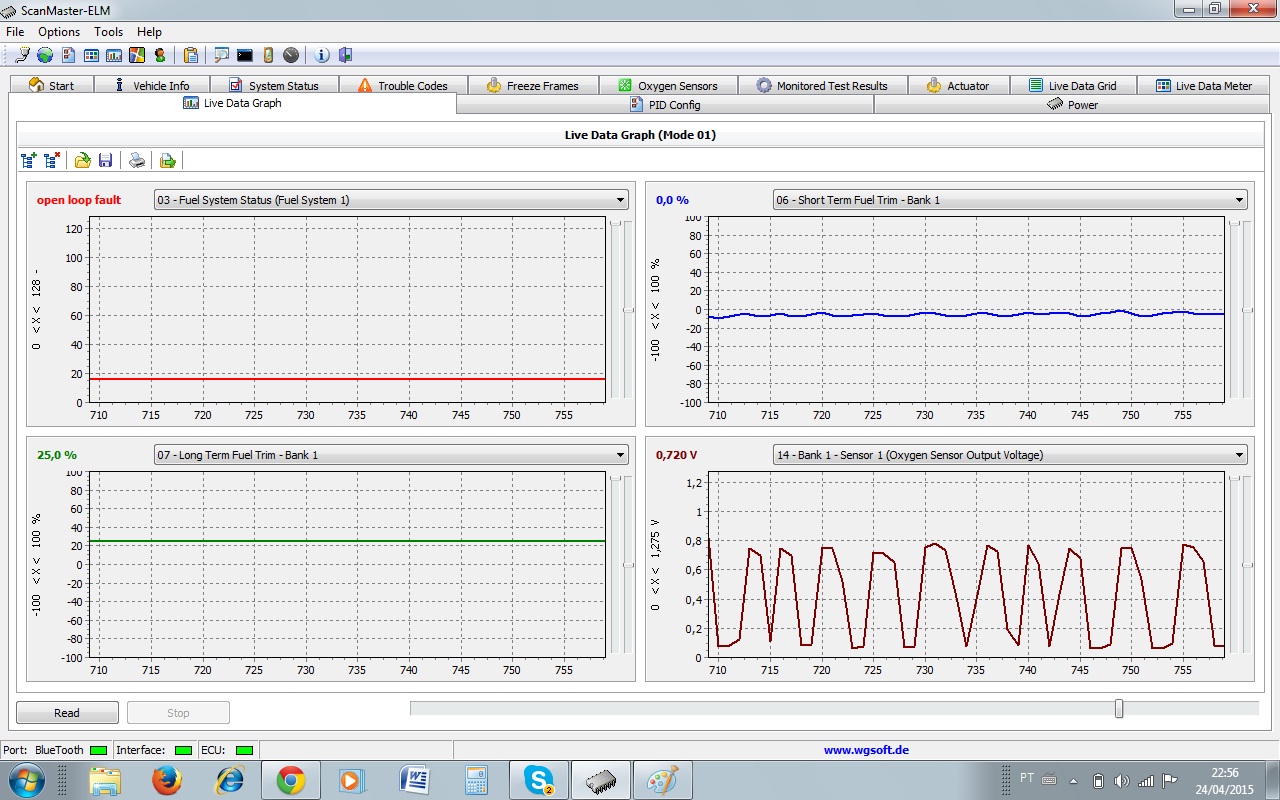

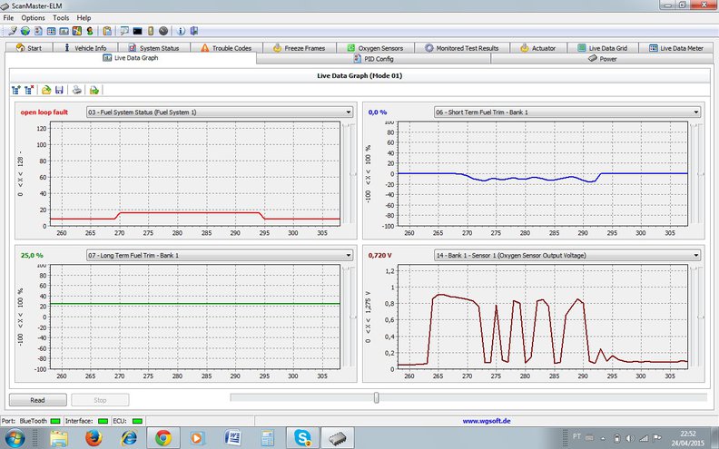

My 1995 Volvo 850 GLT is throwing 2 codes P0131 (Sensor Circuit Low Voltage, Bank 1 Sensor 1) and P0137. It is also throwing P0300 P1310 P0301 P0303 P0304 and P0305, but I guess it is misfiring due to a bad fuel trimming or a bad response from O2 sensor. Engine is hard to start when cold and sometimes when hot.
Recent changes:
Front O2 sensor (universal)
Spark plugs (bosch)
Fuel filter, air filter
The engine only misfires when engine is completely warmed up (when driving for about 25 miles) or when there is more than 3 engine starts, also when hot.
My question is: How to solve that O2 sensor problem? (if it is the real problem)
I've done some reading with OBD, it follows below
There is only variation on the output VOLTAGE and Short Term Fuel Trimming when the loop is closed (FAULT)
When the loop is closed, there is output from O2 sensor and STFT operates. When the loop is open, there is no response either from O2 sensor and STFT
With the car stopped, and accelerating at around steady 1800rpm, the loop is closed and there is normal response either from sensor and STFT

So I did. Short term fuel trim locked on 0%. Long term fuel trim locked on 25%. Temperature is OK (90°). Idle MAF 5g/s (is that normal?). Idle throttle position sensor 12% (was not supposed to be 0%?)
