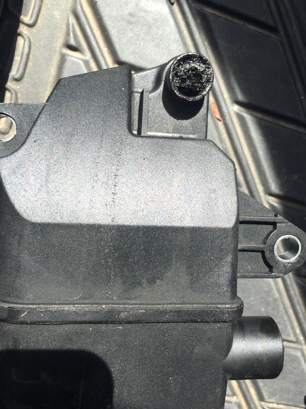

Replaced PCV oil trap and associated hoses. As you can see, it was badly clogged and needed replacement. Cleaned out the ports on the block and put in new unit.
Started car, drove for a bit, shut down, restarted and CEL came back, once again with P0079.
At least it wasn't a wasted repair. Now I'll probably have to pull the oil pan and replace all seals, even though oil pressure seems good. Next on my list is the variable valve timing pulley and if that doesn't do it, I'll assume the engine has some kind of chunk clogging it up and I'll have to junk the vehicle or get a new engine.
Any thoughts?
