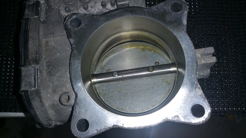

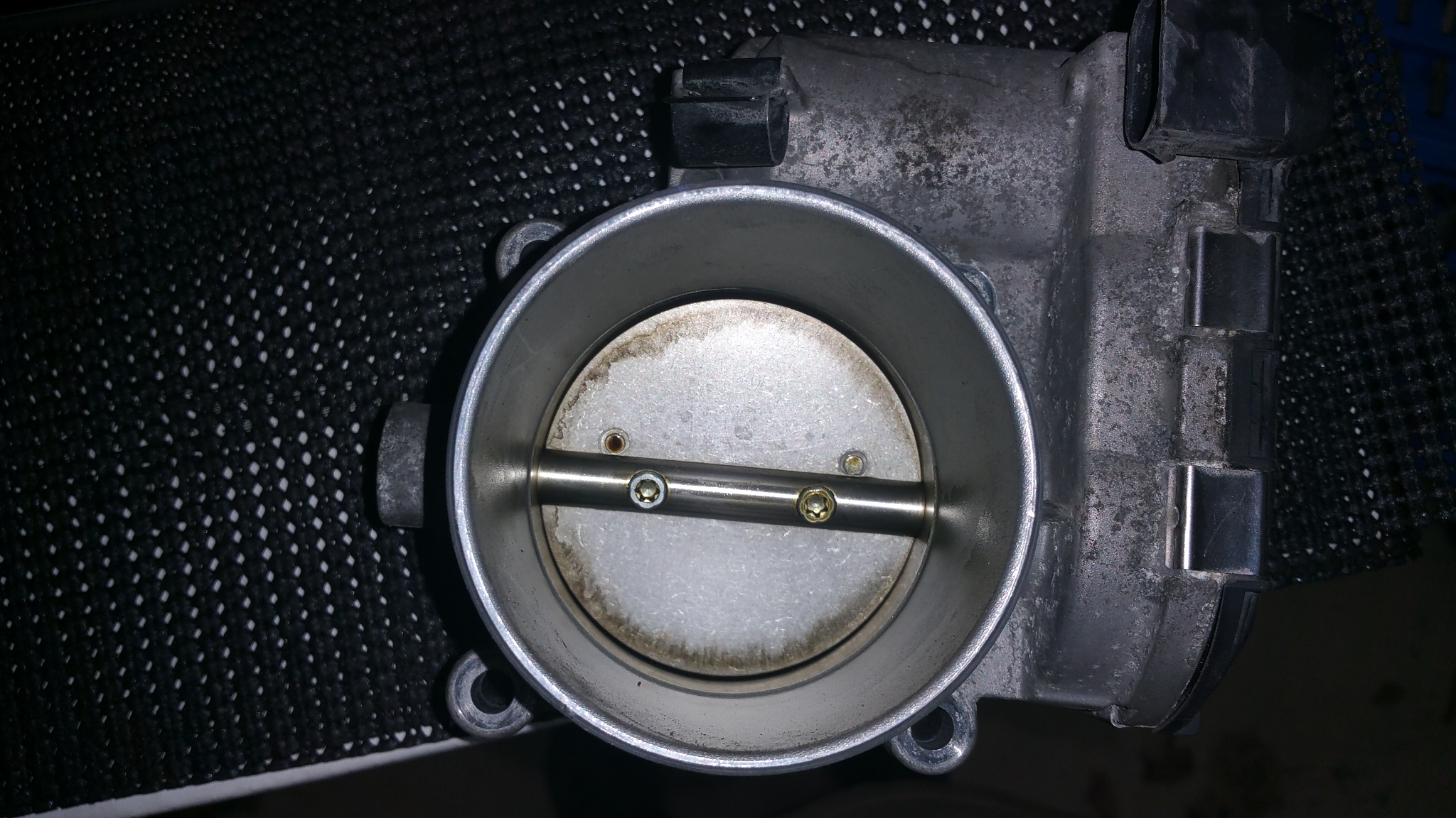

Quick update. Only a year on the throttle body has more grime on it than I would have thought.
The electrical connection is a harness with the most tiny of possible pins so I just sprayed some non residue electrical contact cleaner on both sides of the connection.
FYI I remembered not to drop the bolts when removing (4x 8mm) but dropped the throttle gasket into the nether regions of the engine bay. It must have taken 20 min to find and retrieve it requiring removal of the belly pan.
