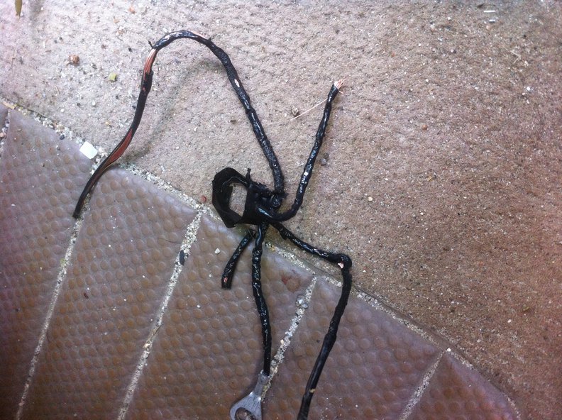

Update time! I jumped 12v to the green solenoid wire and the starter just barely moved. So I jumped 12v to the starter side of the solenoid with heavy gauge wire. The starter turned the engine very slow and just for a half second. The battery is showing a healthy 12v and maintains 12 while trying to start. Decided to change the starter, but still no good. Pulled open the steering column covers and found a charred black wire that looks like a ground for the switch. Any suggestions?

Post by Ozark Lee »
Post up a picture of the melted wire and we will do our best with suggestions.

Post by Broken850 »
I removed a good section of burned wires and repaired several that I couldn't replace. She fired right up, but is hesitating. I'm thinking I have more damage elsewhere. Tomorrow is another day....
