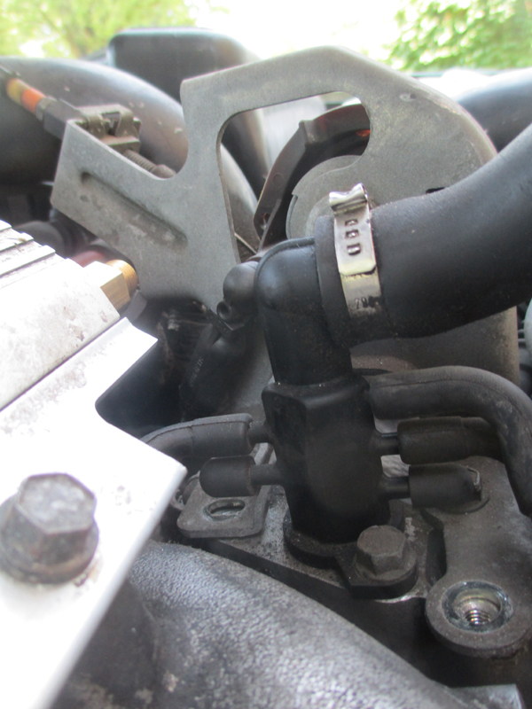

Hoses: I found one slightly loose hose clamp and one suspicious looking 90 degree-er coming off the vacuum tree. BTW, my tree has two ports capped (I will try to attach a pic) but I think that is normal for my engine because I didn't cap them and I've owned it for 15 years at least.
