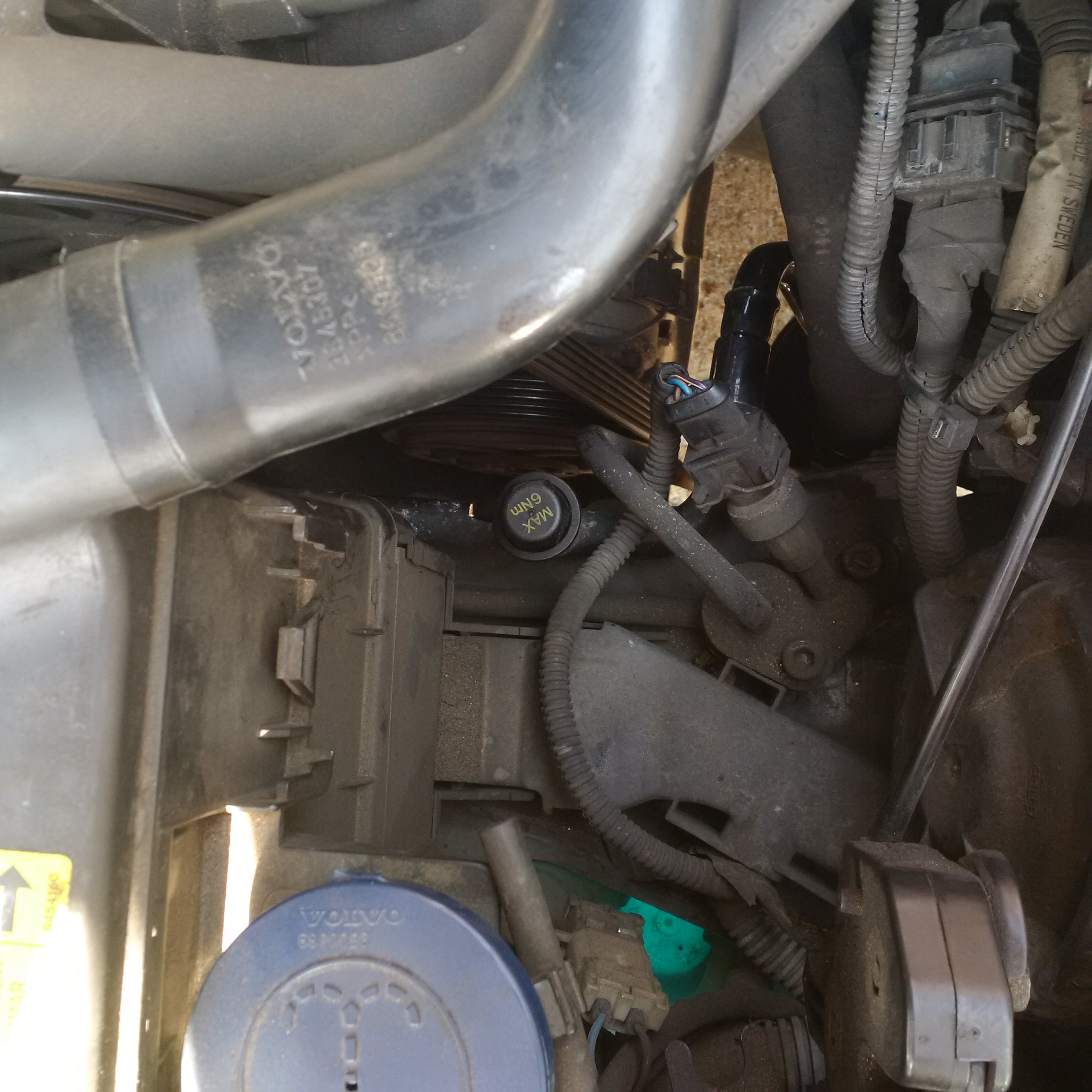

- Is there only one recharge port on this car? I find the one along the AC line on the passenger side (see attached pic). It sounds like there's typically a high port and a low port and filling into the wrong (high) one could cause some uh-ohs.

There is only one port and it is the low side port but based on the background I wouldn't just start dumping in R-134A. A low charge typically presents with a rhythmic cycling of the compressor unless it is very low.
