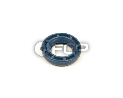

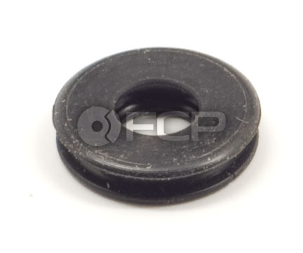

Here's the update.... I reinstalled the intake manifold gasket. I put some ATV on it and along the top. But I think the most glaring issue that I really butchered reinstalling the fuel injectors. The lower fuel injector seals were wrapped around the fuel injectors and I didn't even see them. They were not seated. So I seated them and started the car and one fuel injector was spraying all over from the top. When I removed the injectors I lost (2) of the precious lower seals, and then later a third one. I was REALLY disappointed, but I don't think it would have solved the problem right away anyways because, like I said, the one injector was leaking out of the top. This, I believe, was caused by the fact that the upper fuel injector spacers were missing....which I just figured out. (I saw a couple loose ones on the ground after I removed the fuel rail, and I didn't even put much thought into where they came from....that was stupid.) But I just want to confirm: DO THESE UPPER FUEL INJECTOR SPACERS FIT IN THE FUEL RAIL? I'm assuming so. So now I have to order these super expensive little seals that I lost and put the project on hold until they arrive. Then HOPEFULLY this will resolve the issue. Thanks for your help.
