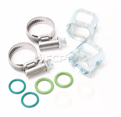

Thermostat & gasket?
You need the seal that fits into the radiator fitting
I use zip-ties around the cooling hose clamps instead of worm-type hose clamps like in this kit
https://www.fcpeuro.com/products/volvo- ... 0-6842411k
