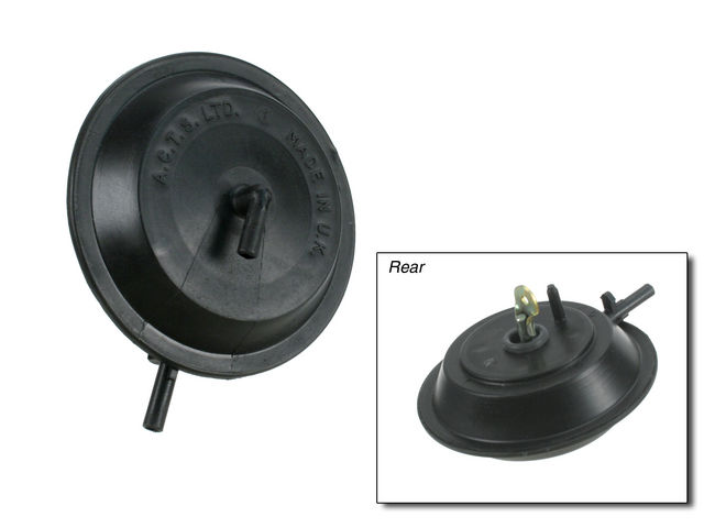

Thank you Jimmy57! I plugged both the detached vacuum line and the fitting from which it was detached, and now the airflow from the dash vents seems unaffected by load on the engine. Next question: which of the plastic whatchacalits under there is at fault? Is this something that might be leaking at a seam and could be epoxy-fixed, or has it failed internally? How difficult would remove/replacement be? If this is likely to consume an entire day or more, I can probably live with reduced airflow to the foot vents.

Uh oh... this does not look like it would be a fun part to replace. Is it necessary to remove the entire HVAC box from the dash to remove/replace this vacuum servo?
It looks like it is attached from the inside of the box, and can not be removed (except perhaps with a hammer) from the outside.
