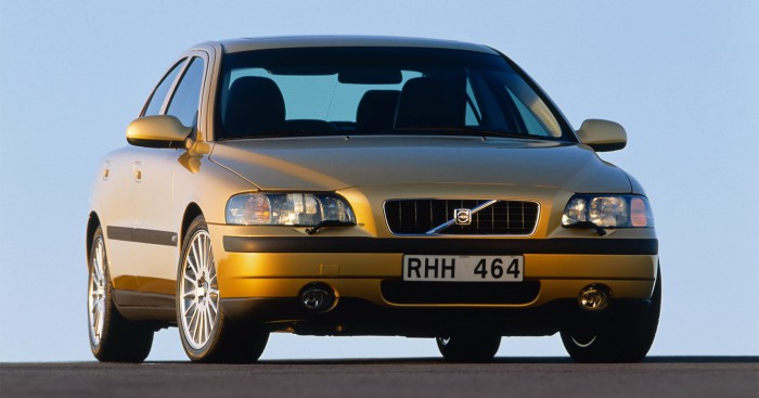

Gold - I believe it's called Maya - is surely .. apart, but now thinking I would have loved one. It's an unique Volvo color, very rare. Sure it's bling and attracts attention, not a good car for someone that likes discretion. But is also the kind of color that when you search for your car in the parking lot you can't hold some kind of a proud feeling.
- volvo-s60-2001-maya-yellow-pearl-700x367.jpg (48.1 KiB) Viewed 2441 times
