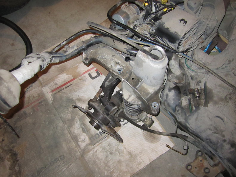

There is no way to access and replace the rear pipe that runs from the LH rear wheel side from the LH jacking point over to the RH side without dropping the whole rear end. Kahl has made the only sensible alternative which is to make up a short length of pipe to replace the wrecked part, or re-sleeve the end of the pipe, but it may be too short to do that easily.
If you look up on my 'rant' on best tool ever, you will see I paid a stupid amount for a Snap-On 11mm flare wrench because of my concern of damaging these pipes. I am replacing the pipe over the rear sub-frame anyway as I had to drop the sub-frame as it failed due to corrosion. Again, you can see my 'blog' on the progress for this. If you can manage to find a way to repair what you have I strongly suggest you go that way unless you want a lot of hurt!!
On the above picture you can see part of the brake line on the RH side of the sub-frame and it runs over between the tank and the frame. If you need it I can take a picture of the routing for you as I have pulled a spare frame and the pipe is still attached.
