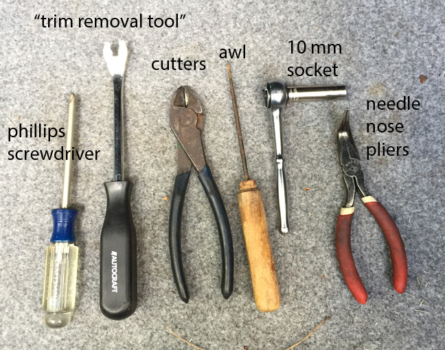

All tools I used on this quick job. The awl was handy when I cut the spring in step 8.

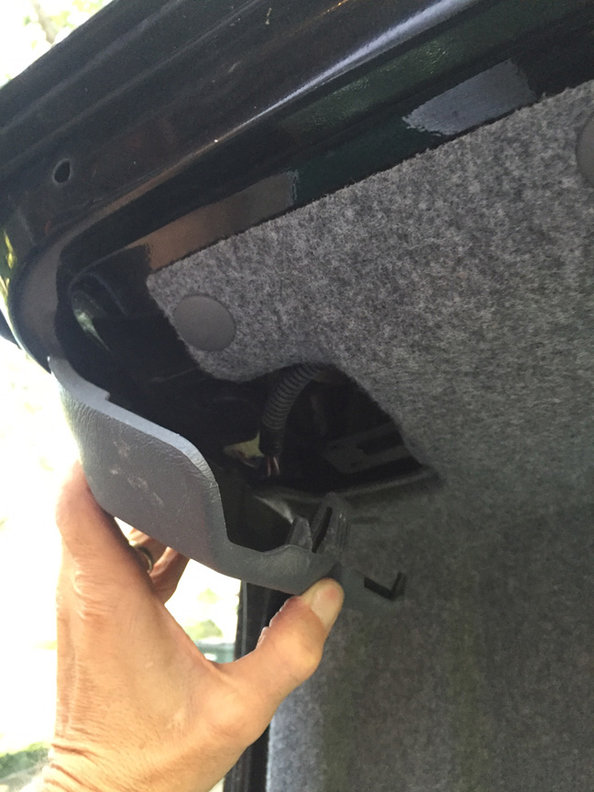

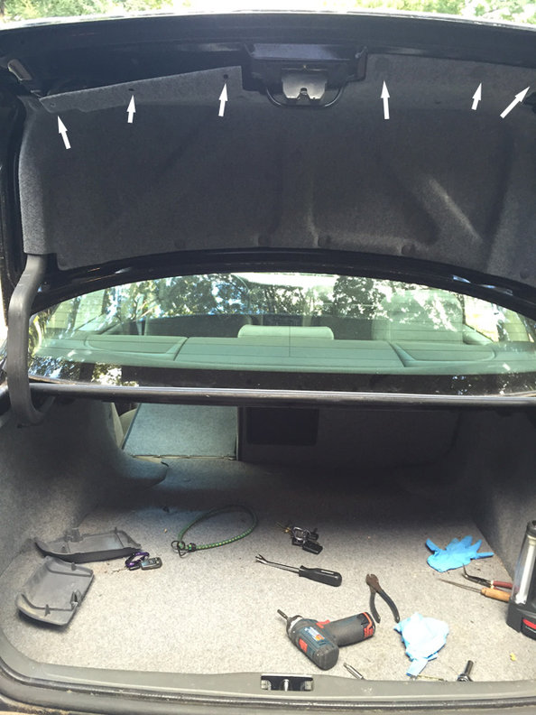

step 2 - remove the 6 pop-in retainers for the edge of the fabric on the trunk lid. I use a trim removal tool, if you don't have one then you may want to treat yourself on this job with some of the $$ you saved and get one, they are super handy.

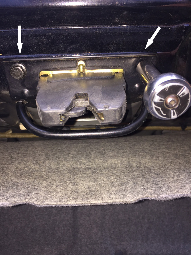

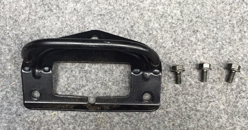

step 3 - move to the center and remove the 3 bolts (10 mm) that secure the pull bar to the latch and mount the latch to the trunk. Two bolts visible here (arrows), the third is up along the inside of the trunk.
step 4 - the latch mount bar drops right off once you remove the three bolts. The latch stays in the trunk lid.

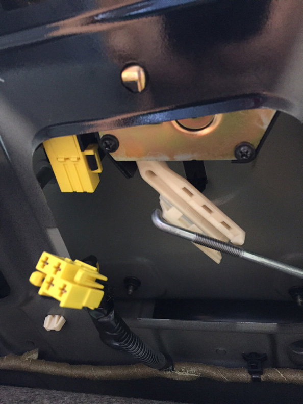

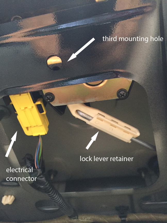

step 5 - eyeball these connectors, in the next step you will unhook them.
step 6 - once these are unhooked, you can remove the latch up and out of the trunk lid from the inside. In this pic it is sitting in the trunk.

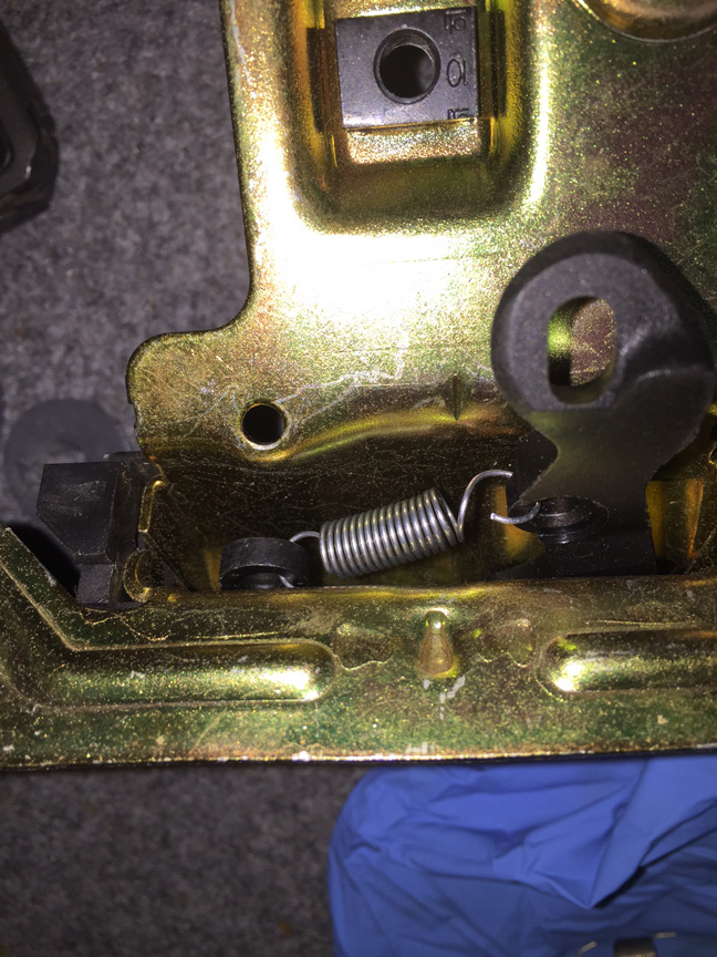

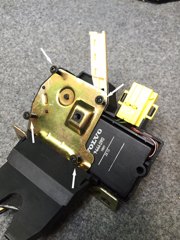

step 7 - remove the 4 phillips screws holding the latch assembly together. Once I did that I saw a broken spring sitting inside. At this stage be careful not to drop any parts or let the assembly fall apart completely. The latch isn't very complicated if it does, just a few levers could fall out/off but I like to keep things together on a quick job like this. If your car has a bad lock actuator, you can now remove the actuator from the latch and swap in another one.

step 9 - new spring installed inside the latch. Click the levers back and forth it will be obvious how it works.
