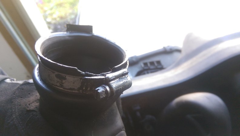

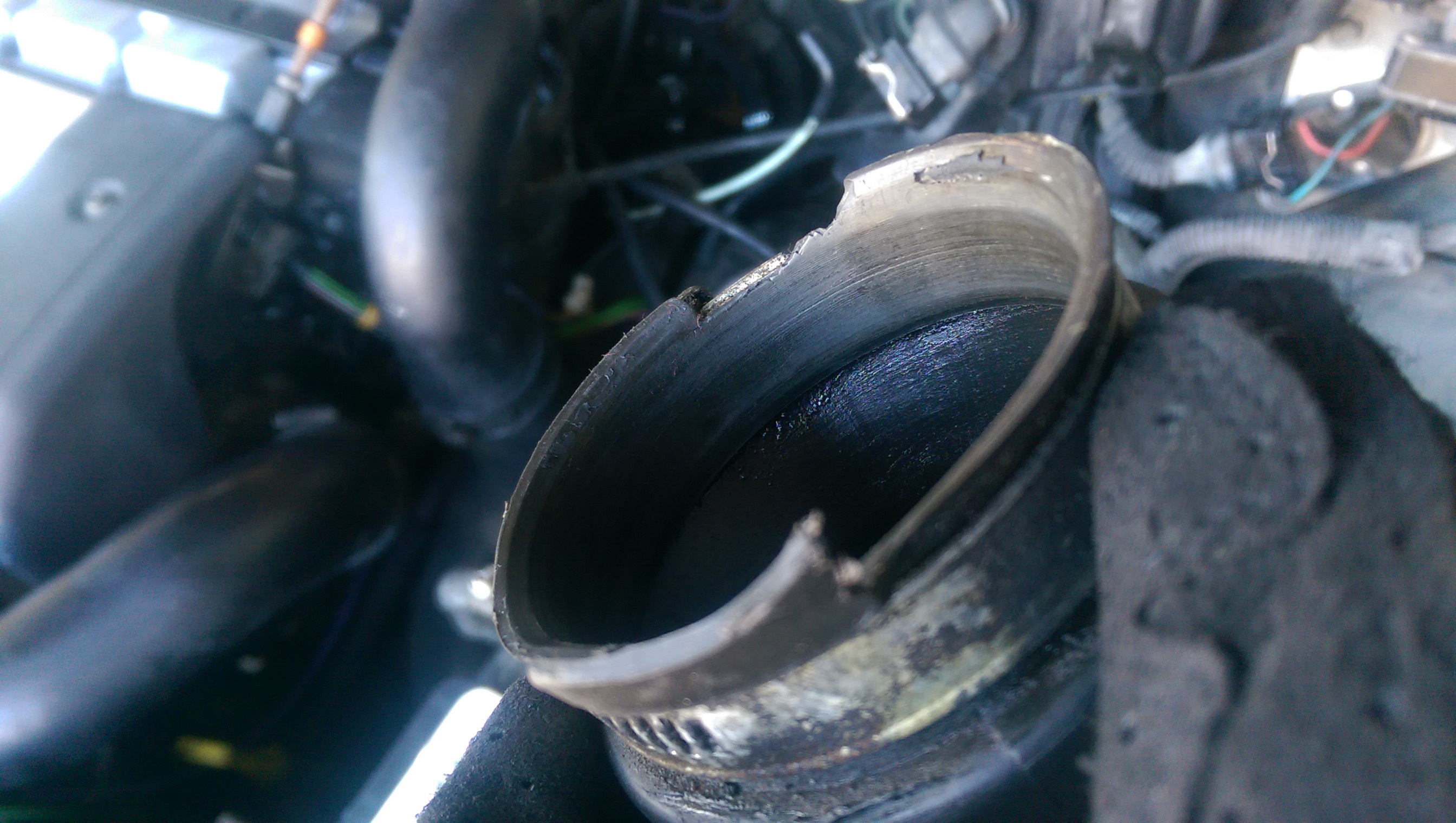

I took my intake out again and found my intake tube had a notch taken out of it. I dont think it is effecting the sealing though. I thought at first that I may be able to hear the turbo operating (and unfiltered air was being sucked into the turbo) through the notch, but I don't think this is the case now.
I can now hear the noise at high rpms in park and neutral. I will be tracking it down later this week. I'm thinking if I need a new CHRA, I will order it from Midwest turbo. Does anyone know if they are a reputable supplier? Not sure if I trust the Ebay CHRA replacements. Sucks that my rebuild was no good. In the future, I suggest to all to just order the new CHRA as its only $350 and you know its good.
