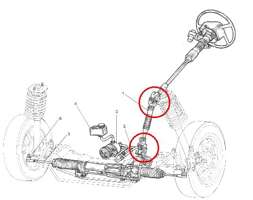

First thing that comes to mind is the steering lower u-joint

Nice graphic thanks to Oregex.
Are the "stiff" and "free" areas relative to steering wheel position?

I would think so. The coupler can be tested in 15 min from inside the car, by disconnecting the steering column and removing the boot cover from the floor, underneath the pedals. It is the lower one in the picture that's the usual culprit.

Well I tried spraying the upper/lower u-joints on the steering shaft. It seemed better for about a day. But then the next day it got cold and it was worse than ever. So, off to shop. They said my lower u-joint was seized and needed to be replaced. Had them replace it and now all is good. Thanks to those who read this thread and gave me some advice - its always good to try the simple fixes before heading to the repair shop. And thanks for the diagram provided, I now know more about what's under the hood of my car!
