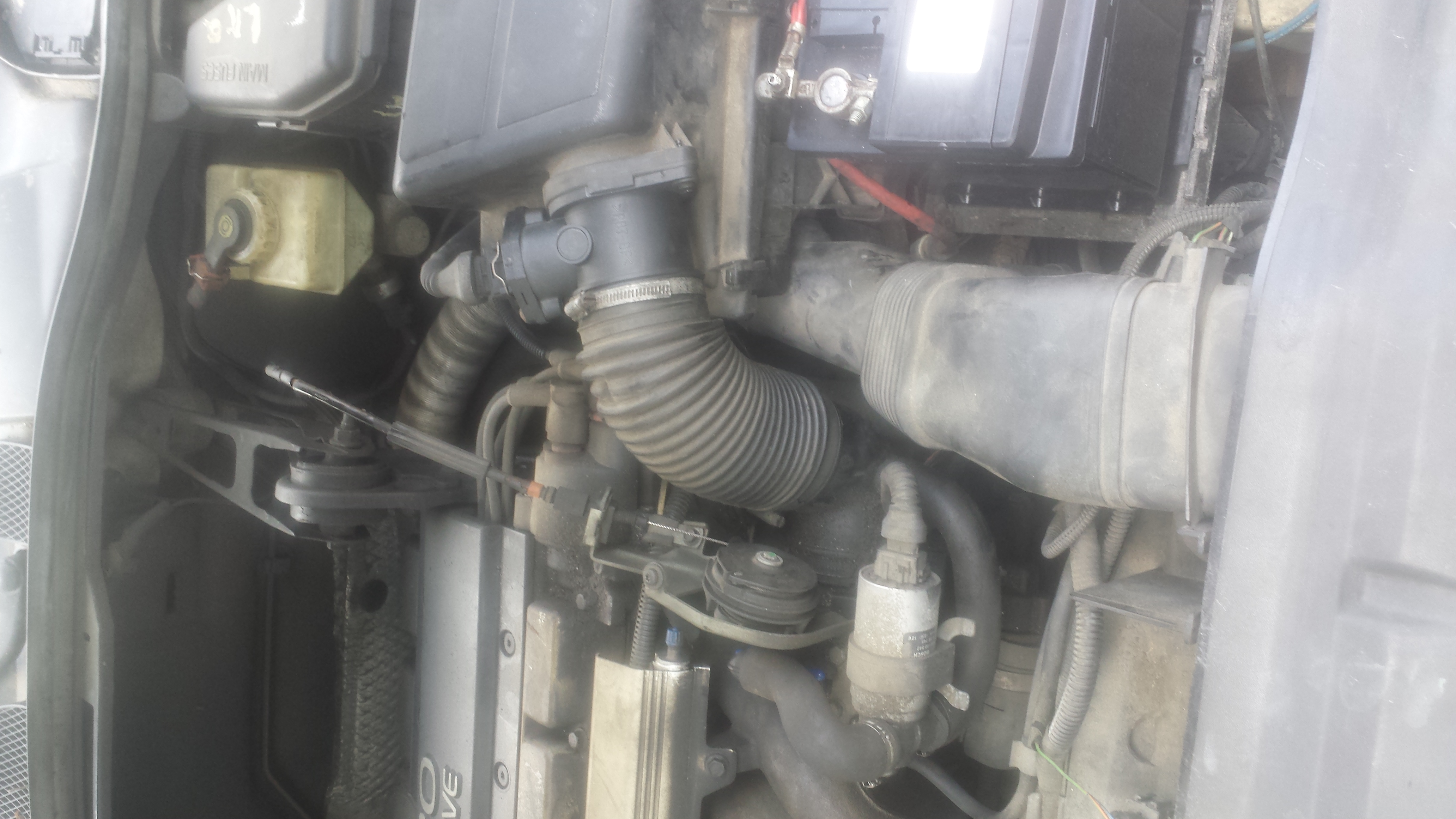

I did stumbled across this bad boy. I'm not certain if this may be the source of my problems, but it does not look connected properly (Center of second picture). I'm not too sure what it is exactly so can anyone tell me what I'm looking at. I know it is by my MAF sensor. Here are a few pictures of what I'm looking at and my perspective.

Those pics are not of a '99. A '99 will look considerably different under the hood, as you would have an ETM instead of a throttle body.

RussB wrote:Those pics are not of a '99. A '99 will look considerably different under the hood, as you would have an ETM instead of a throttle body.
The thing is, I dont doubt you. It was sold to me as a '99 but mechanics identified it as a '98 so i've been confused about that.

Does anyone know if that dislocation could cause a problem in my EVAP system?
