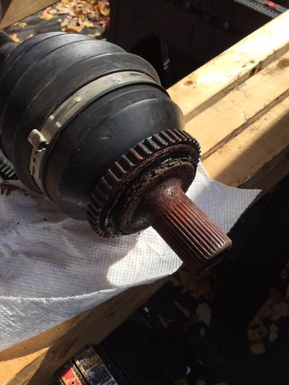

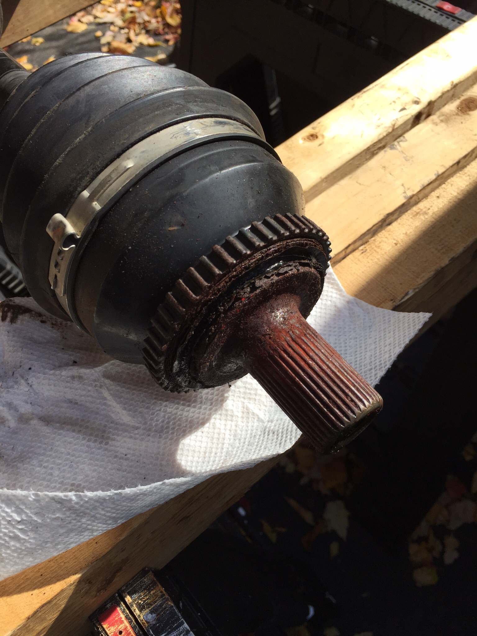

Removed two 12mm head bolts from the clamshell mount, tap off the lower half of carrier, and the axle came off with hand pressure.
Now to get return to the programming of getting the stub out of the steering knuckle

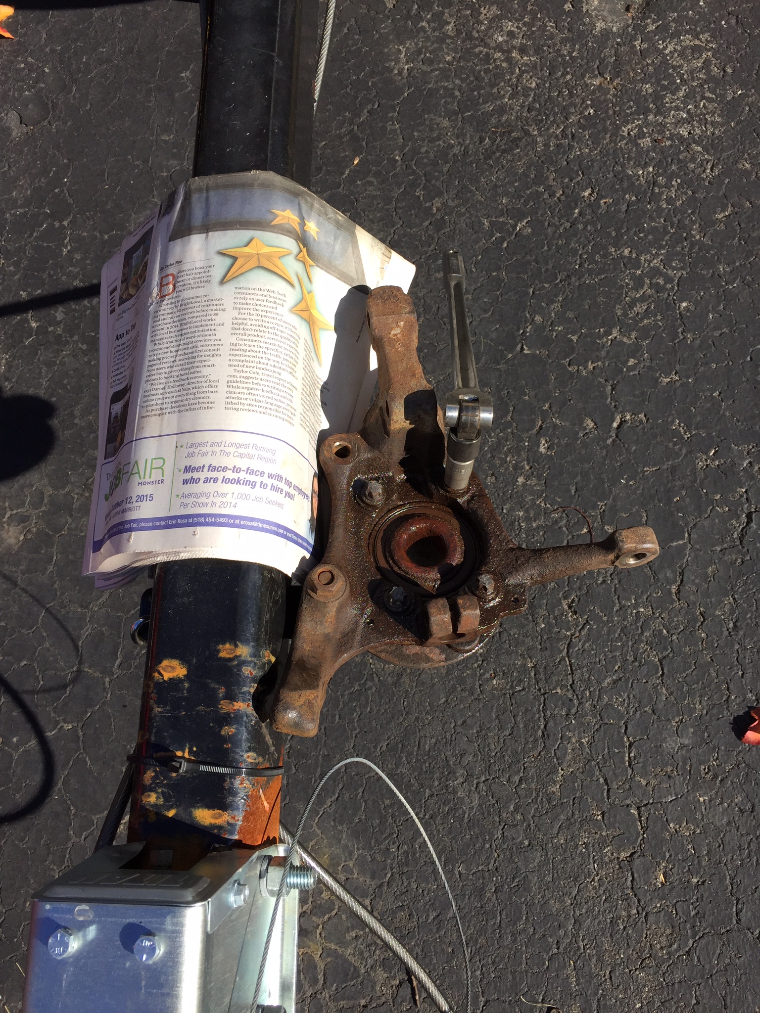

Well, after hitting it with a drift for an hour, acetone/ATF, heat, etc...im out of tricks
Im also 90% certain I have broken another CV cage even though the stub axle has not moved. Don't understand that, maybe the axle has just come apart as its loose from the car.
Ill take it to my local indie who has a press, get the hub out, new bearing in, and evaluate the driveshaft.
