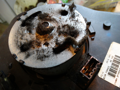

So I removed the fan to check its operation and I'm fairly confident the plug is the culprit. a lot of red residue (looked like paint) on the contacts cleaned off as well as 20 years of fluff. The motor is made by Delco USA so it should last another 100 years?..there was little or no play in the bearings yet I still sprayed WD-40 on it and now my air smells like WD-40.
