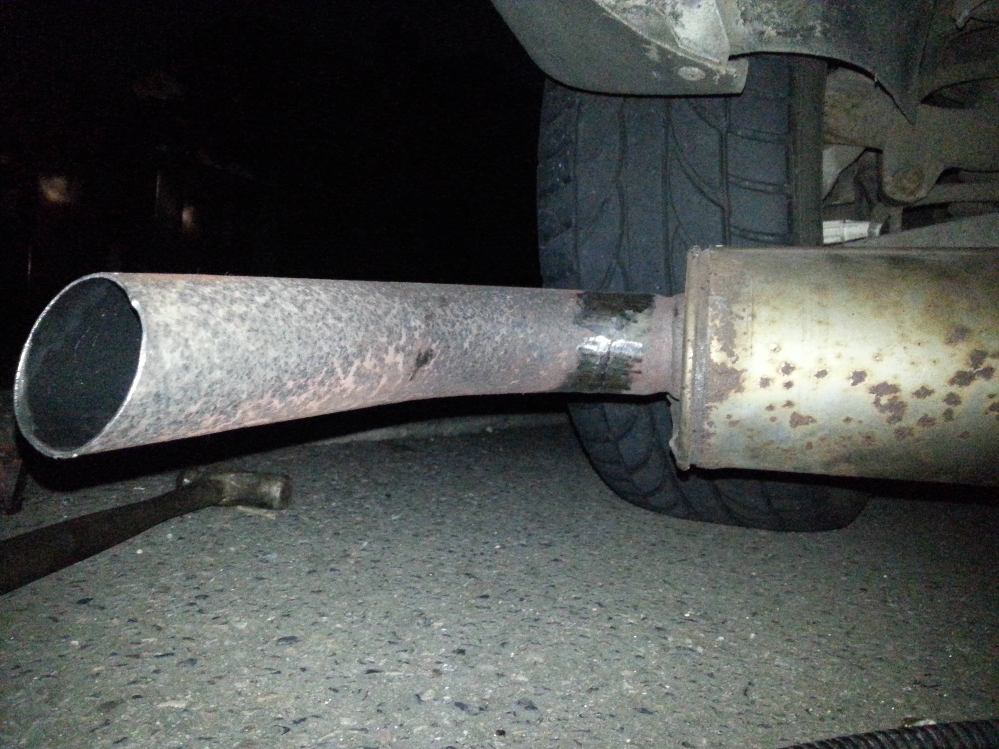

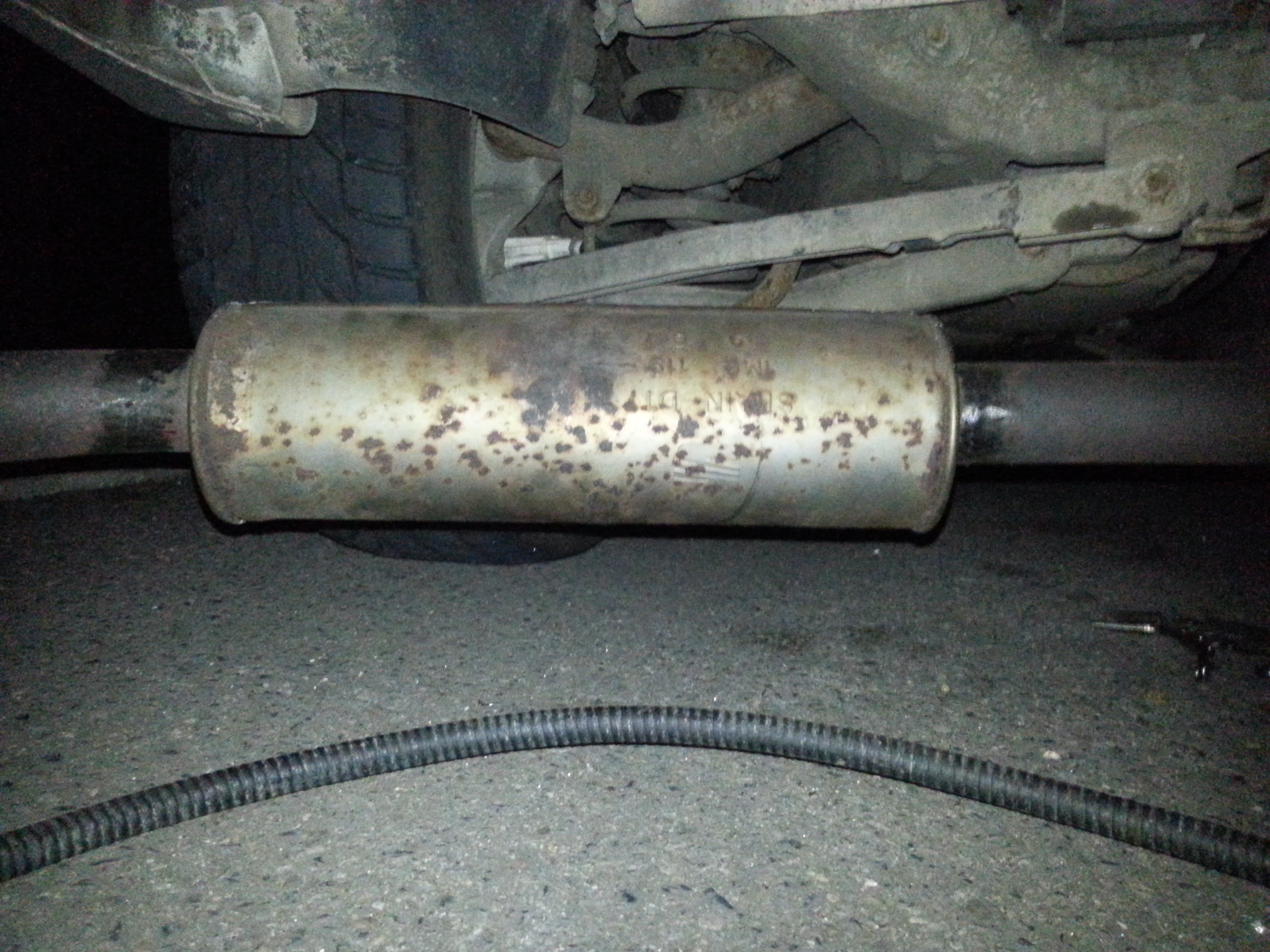

This is what happened a month ago when I got bored, don't worry as I said I'm going stainless soon, I just wanted to have a play about and get the cobwebs off the welder, sounds nice though it's a center box off a seat cupra r (ibiza).

I dig the exhaust! I miss my welder, there's always something to do when you have a welder!
